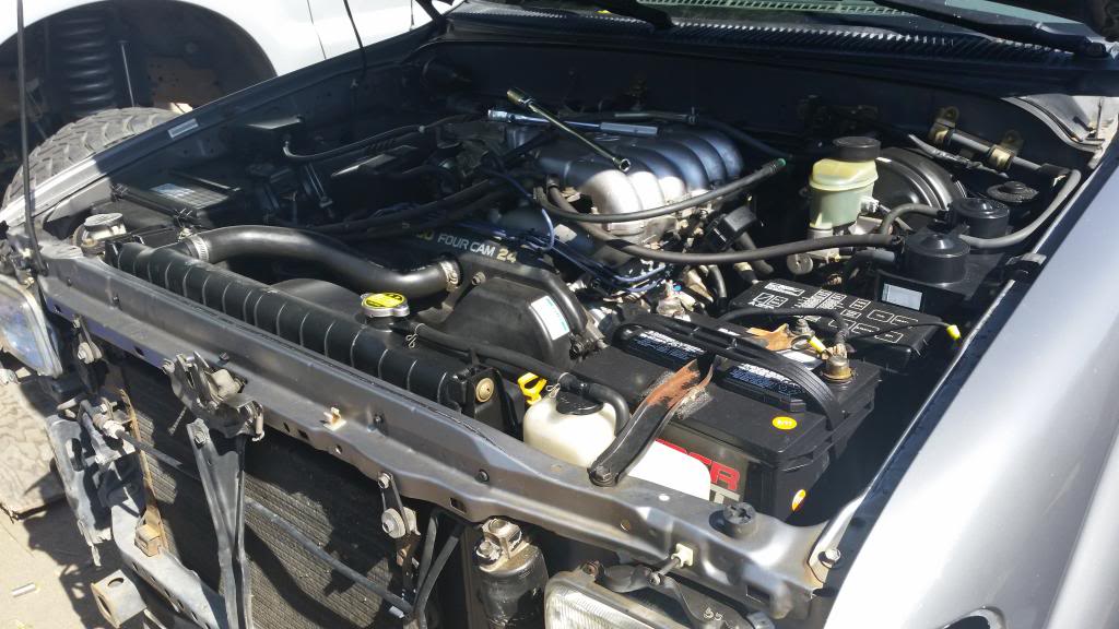

Yours is a twin to mine under the hood (except I have no clutch master cylinder) and just as clean.
Take a look at all the fluids and pull the tires to inspect the brakes. Make sure there are no frayed strands on the + cable at the battery terminal....it's inconclusive in the photos.
While the vacuum hoses look good, take a look for any cracks or cracked ends. Also, check the air cleaner and PCV valve. Doing the basic maintenance checks is always a a good idea on a new-to-you rig.
Use only Toyota OEM, Denso, or NGK electrical parts. This engine and ECU does not like other brands. Use only dual electrode spark plugs.

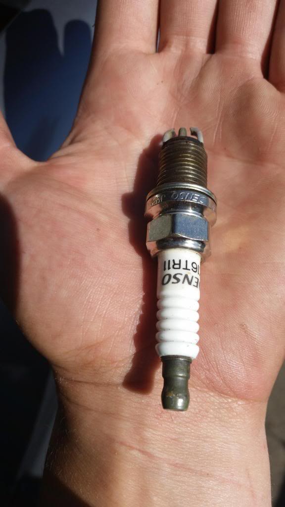

Spent a little time working on Clifford the Third today - replaced the cracked front bumper (plastic part only, but going to do the metal soon). Played around under the hood a little, spark plugs look okay.
My boyfriend says the boots on the ball joints are leaking. Are they going to be hard to replace? What happens if I put it off?

Upper or lower ball joints? Why I ask is that the lower ball joints have a nasty habit of separating on rigs of the age of yours. It seems to be just a wear issue and they give no warning before going as members around here have found.
Highly recommend using Toyota OEM and the lower ball joints will run about $80 per side and are easy to replace. The uppers have to be pressed in and out but can be done with hand tools and are about $40 per side.
IMHO, best to replace them all.....it will save you a bunch of $$$$ versus breaking one and then fixing the ensuing damage.
