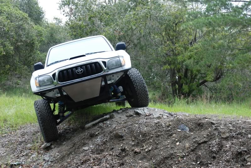

Little bit newer truck, but these are the 33x10.5's from the front. I like how the narrower tire looks, and I personally like how it performs better than 11.5" or 12.5" tires, just MO

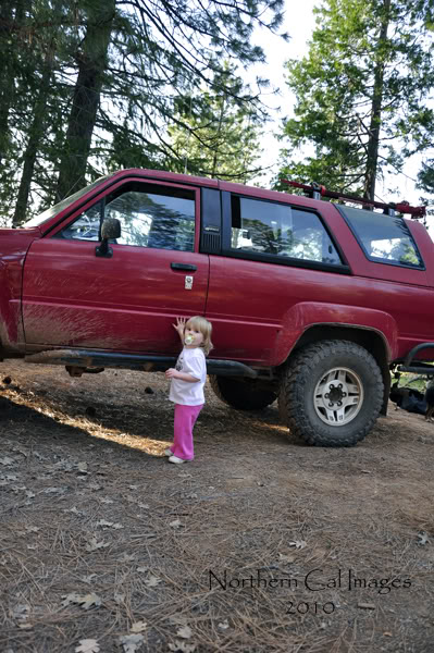

probably a good idea to think about a regear 4.88 would be nice. heck i am rolling 31's and a regear would be nice. how hard was the auto to manual swap? I do not run 33's (yet) but here are my 31 MT's
Pre slider

And last weekend

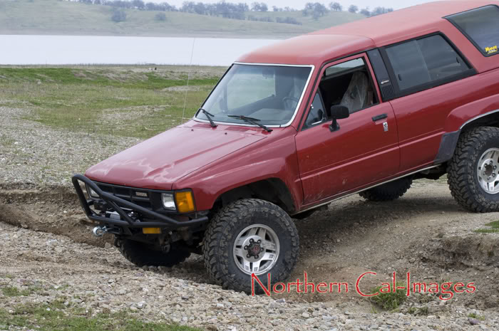

Another pic for you...
33x10.50 BFG's on 8" wheels. I've got 4.88's, and I love it.

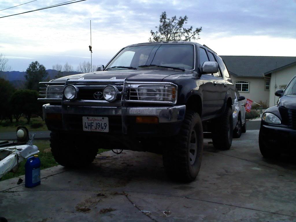

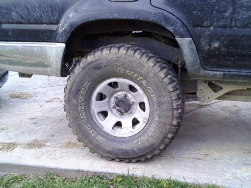

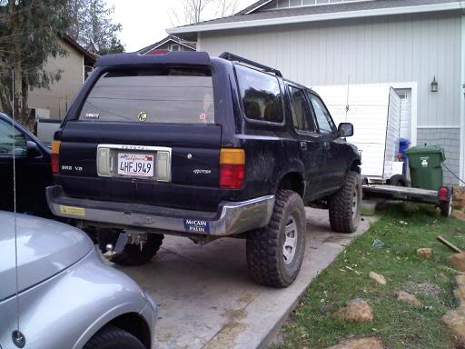

Mine's not a pickup, but I have Dunlop Mud Rover 33-12.50's.
The 33's fill the fender well esp. with the lift listed in my sig.
And one of the front.
These are the most recent pics I have..... Sadly, they were taken in November.
