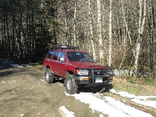

well hear it is so far i have done brush guard new 31.10.50.15 roof rack what now got to fix my 4x4 i have auto lockers but when i put it in 4x4 my front weels dont lock up any tips v6 5spd

Have you followed the lines that go into the front diff to make sure they are hooked up and have no breaks from the diff to the acuator on the right side fender?? they are vacume lines and can crack or come lose/off from the accuator and you end up where you are now with no 4wd.
By the way not that it matters in this situation but are you 5 speed or auto??

When you say auto lockers do you mean you have auto locking hubs or more likely on your year the ADD system? Just an FYI, but auto lockers actually refer to an aftermarket traction device you can install in a differential. ADD is a system that disconnects the driver's side drive flange (2wd) and reconnects for 4wd. Auto hubs are just that, hubs that engage automatically when you shift into 4wd. I don't think any of the second gens came with auto hubs though. I could be wrong.
