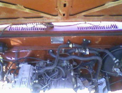

Originally Posted by 1st Toyota
That ass that I bought it from must've removed it.
take a few pics of the motor well and post them up it might have the cap off that says diagnose.
it also could be hanging down the side
Old Jul 11, 2008 | 06:29 PM
bigt's Avatar
Joined: Nov 2007
Posts: 3,278
From: chippawa niagara falls ontario
take a pic of your engine bay.. we will find the diagnose port for ya
