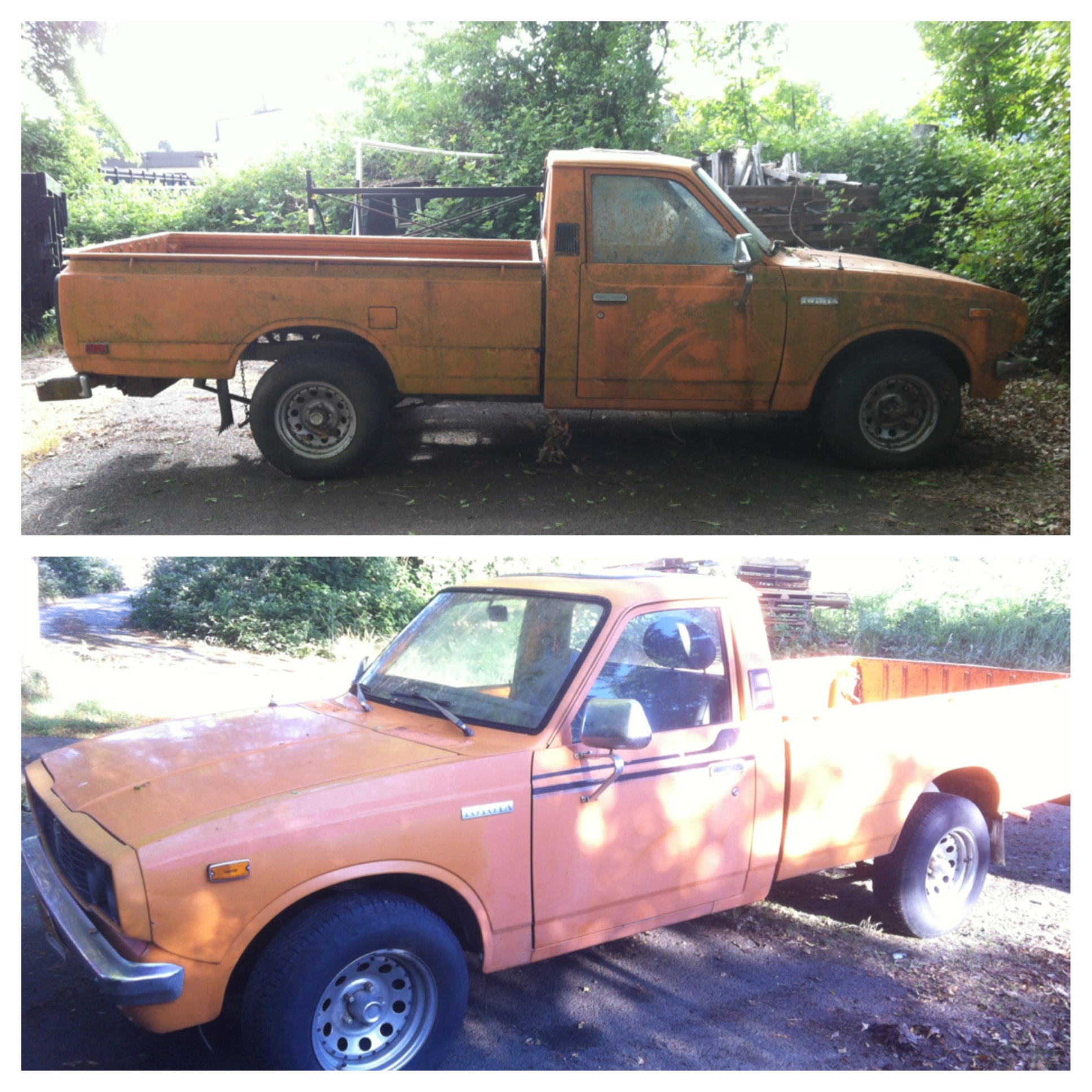

Here's a picture of it before and after I pressure washed it.
