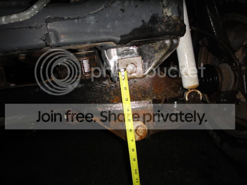

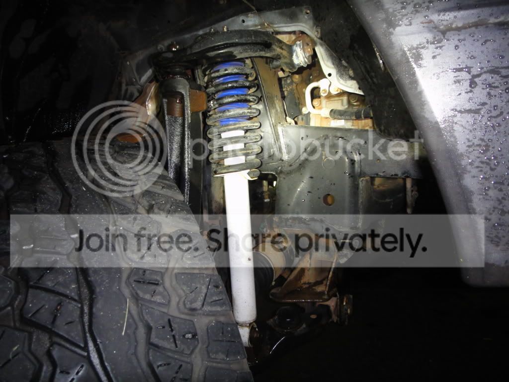

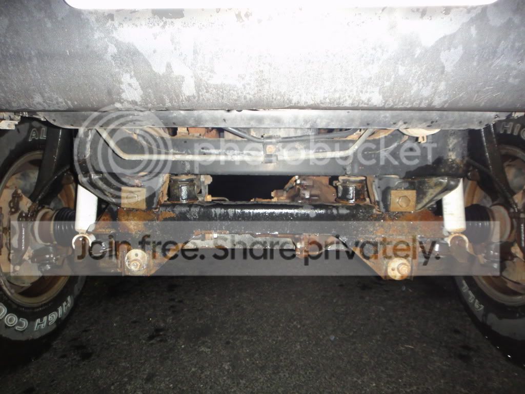

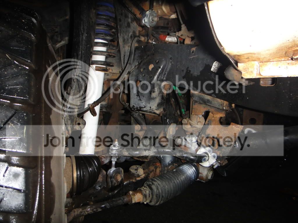

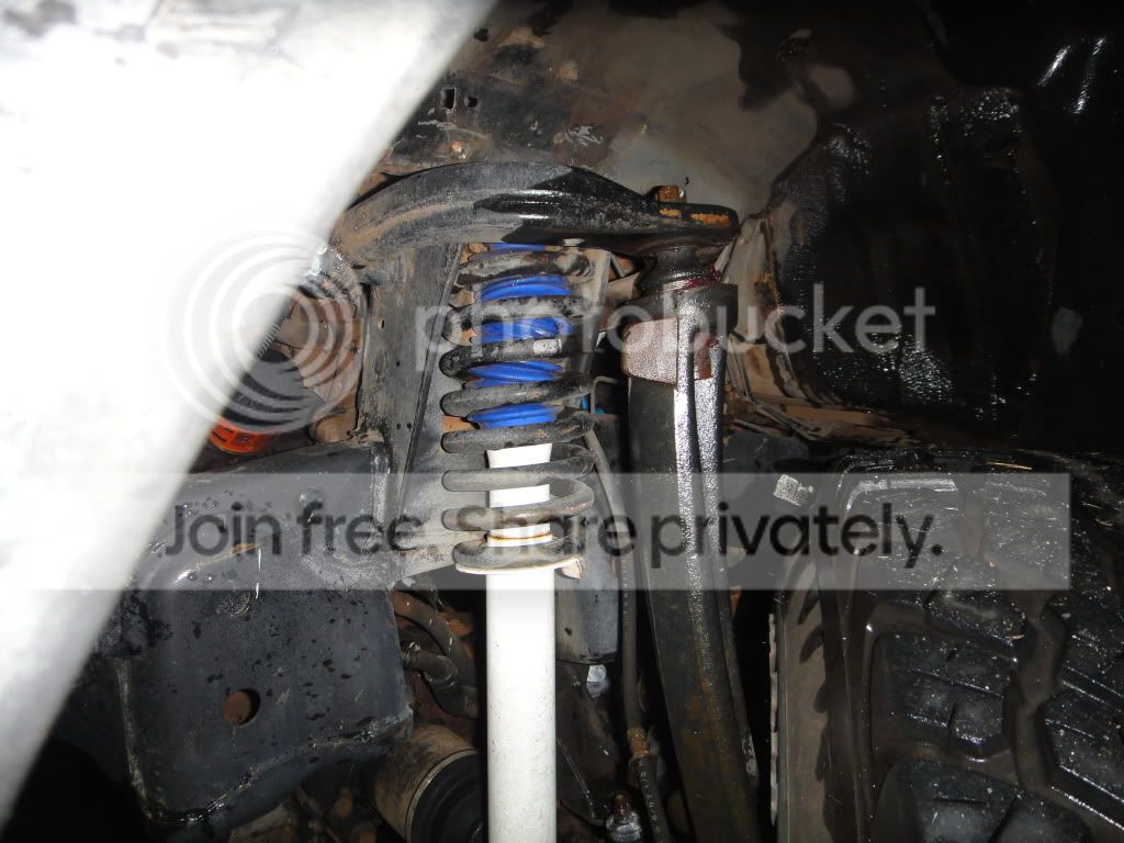

ok so i have a 98 tacoma 4x4 with a 6in lift i believe it was lifted with trailmaster 6in lift first then had fabtech spindles and struts put on it from what i read the trail master spindles had some problems.
so i just bought this truck and i would like to lower it to a 4 inch lift how would this be possible i made a thread about coilovers a week ago and then i actualy found some but realized it wont work cause i am already sitting to close to the bump stops if i drop it 2 inches with the coils i would be sitting on the bump stops.
so how could i lose 2 inches i only really care about the front i know how to do the back i posted some pics so you can see what i am working with.
if anyone can give me some ideas it would help allot this truck is just too tall

not to offend you or anything, but I almost vomited when I saw those pictures, especially the last one.
Did the sway bar drop bracket snap in HALF?!
Get rid of it before it gets rid of you. Then get a proper lift haha

yes it did just snap thats another reason i would like some info if you have any use full advise it would be good

I'm not terribly familiar with the post 95 trucks/4Runners to be honest, but that drop bracket doesn't seem to be holding up all that well from the looks of it. Pretty rusty and nasty for the most part.
What do you plan on doing with your truck though? If you don't plan on beating the piss out of it offroad you're probably fine leaving it on there for now.
Reducing the lift without getting a new bracket lift is going to be tough though.
How's the back look? lift springs or is it a block lift?

it looks worse in the pics it does have some rust on it
