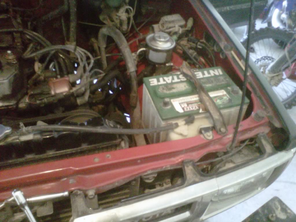

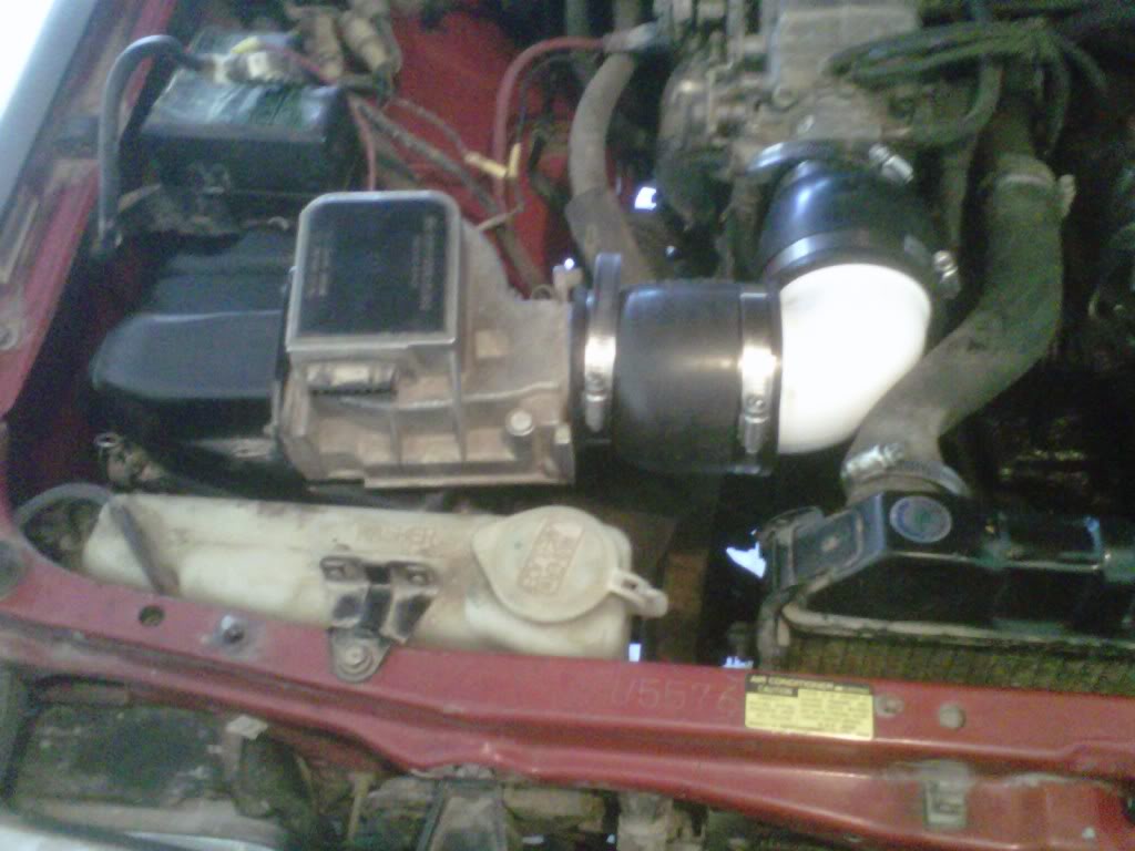

Old Nov 22, 2010 | 12:37 PM
  #24
GreenYot's Avatar
Joined: Jun 2010
Posts: 6
From: Bend Oregon
The intake/Battery swap is a must. Did it to my '86 and got 2 more mpg and more snap, and thats with the stock filter! K&N cone might have to be in my near future...
Size:  81.2 KBName:  Battery.jpg
