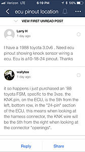

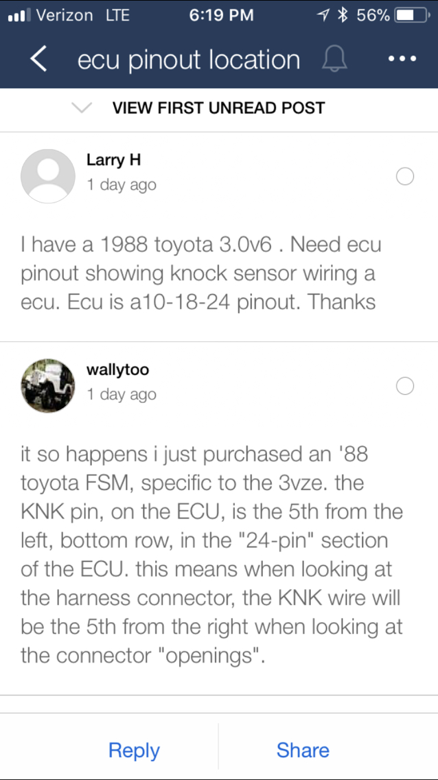

You have another thread started on the same problem. Your question was even answered before you created this thread. It is much easier to keep to 1 thread.
Here is a picture of your answer
