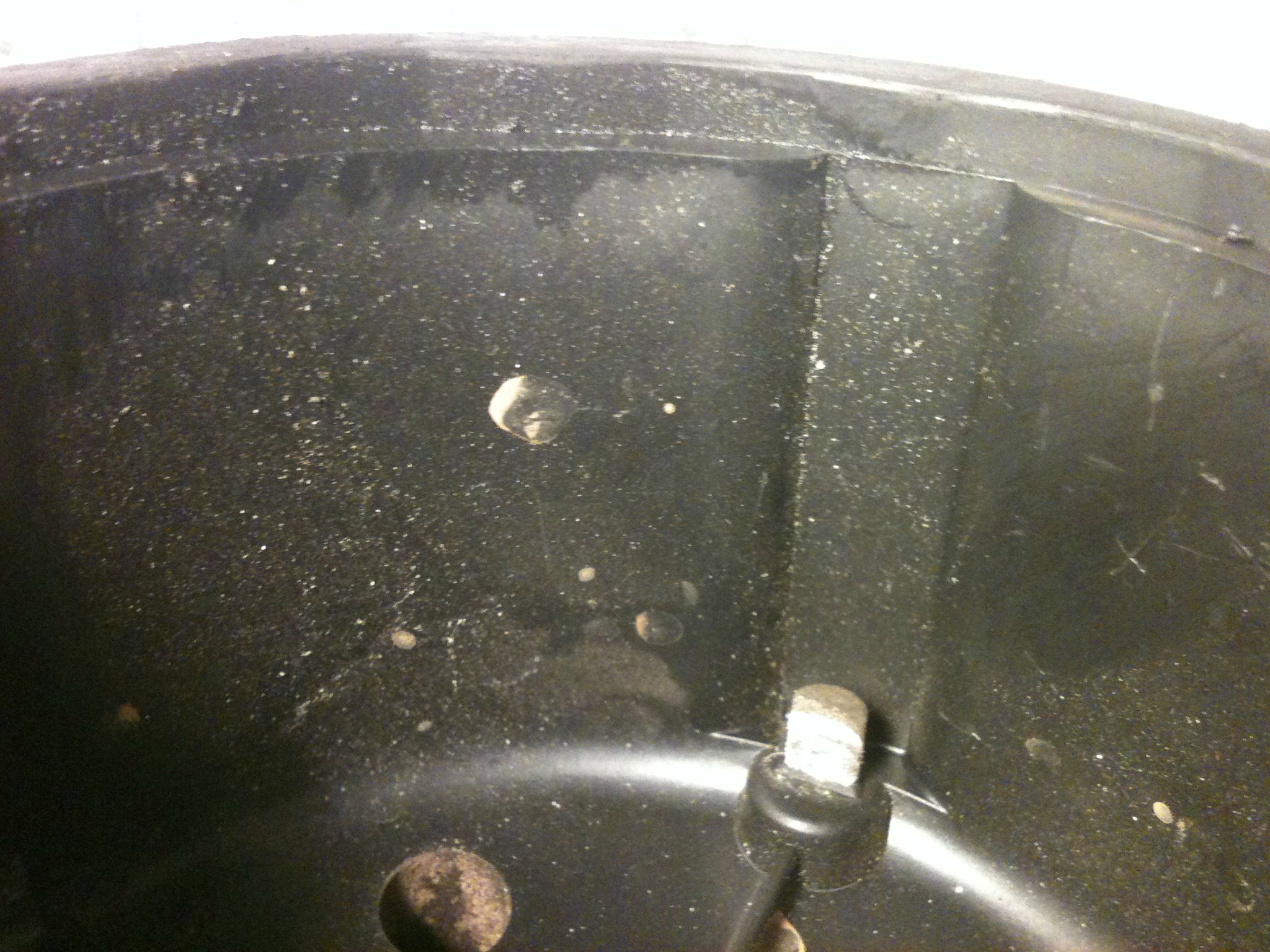

Old Jan 16, 2013 | 05:30 PM
Jadri's Avatar
Joined: Sep 2008
Posts: 44
Here's the cap
Intermittent stutter/sputter 22RE-qhses.jpg
all 4 terminals have corrosion, rotor looks ok
Old Jan 16, 2013 | 05:32 PM
HighLux's Avatar
Joined: May 2010
Posts: 2,587
From: Ofallon Missouri
Well...go get a cap and rotor. That thing looks terrible.
Then we will go from there.
Old Jan 16, 2013 | 05:40 PM
Jadri's Avatar
Joined: Sep 2008
Posts: 44
Haha yea I'll have to get them tomorrow, the dist o-ring is also completely fried. Thanks!

Old Jan 17, 2013 | 06:06 PM
Jadri's Avatar
Joined: Sep 2008
Posts: 44
Alright so I got the new cap and rotor in and the truck is running good: no hiccups and seems to have more pep in its step, too. I think I got off easy, the cap and rotor were less than $10 out the door
