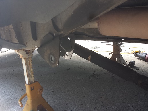

When you say hanger. Do you mean the shackle it self or the shackle mount got cut? If you can take a picture or 2 it would help us tremendously. If you cut the shackle I can't imagine new ones being that spendy. But they might be. The leaf spring connects to the shackle to the shackle mount, and the shackle mount to the frame. What part did you accidentally cut?

Here are some pics of what I'm talking about. The one title sleeve is what I cut. In that pic (from outside to inside) you see the leaf spring, bushing, sleeve, then bolt. I need a new sleeve.
The second pic titled hanger is the location where the spring mounts.
