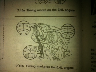

Do you have any pics of your cam and crank alignment when you did the timing belt?

I don't have photos of my cam alignment but I have the crankshaft picture . I followed the image from the Haynes manual . I am 98% sure all the hoses and lines were replaced correctly, before disconnecting I labeled both sides of each hose. I suppose I could take the timing cover off and triple check my alignment, which I'll try and do tonight. The gargle sound does sound like liquid but only happens when I try and keep the motor alive. I've been looking in the manual for some diagram of the intake system but haven't had any luck. I'll continue my search. Thanks for your help.
