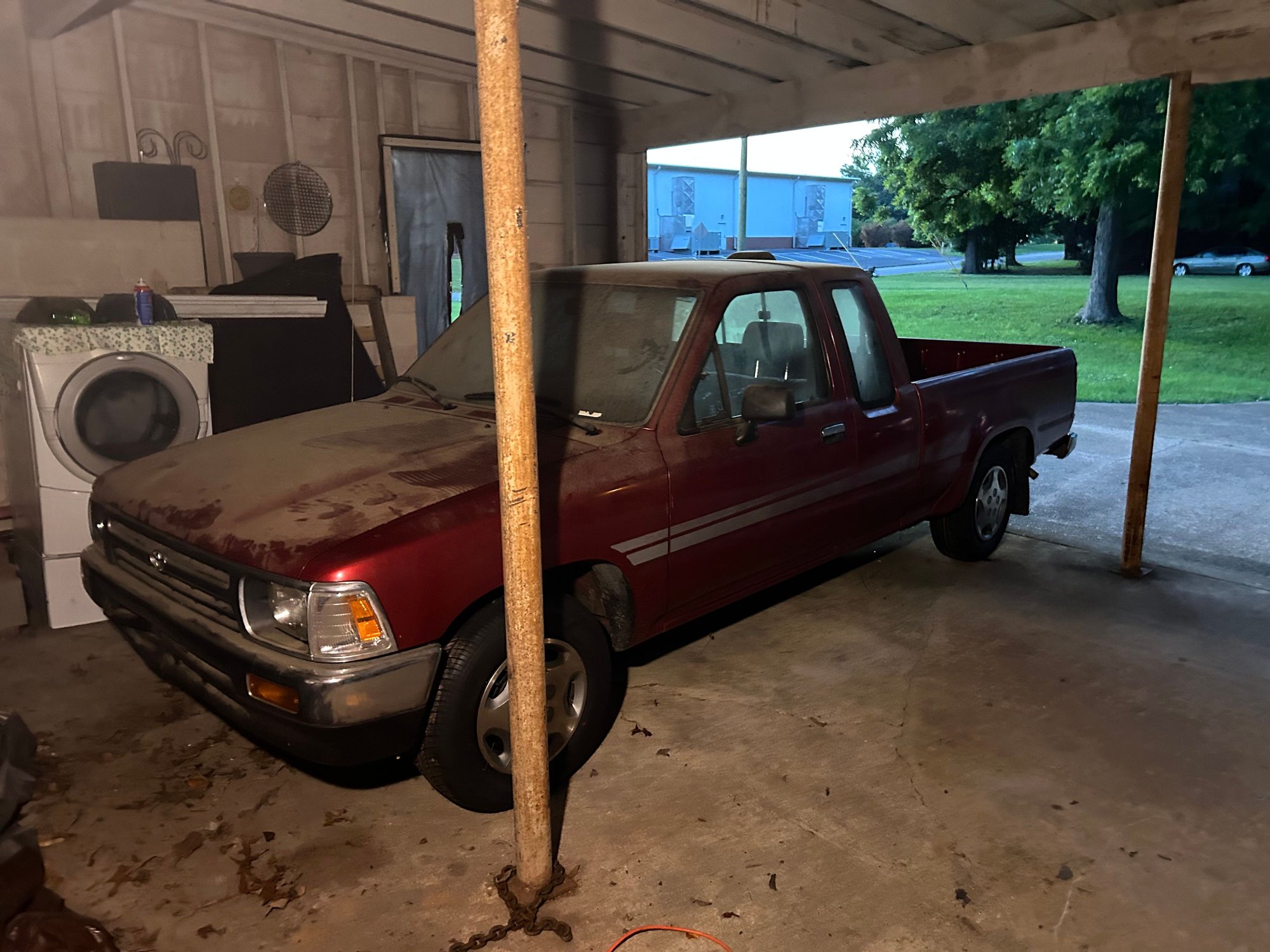

I’ve replaced the fuel pump my 93 sat for about 9 years under a carport and I’ve been trying for weeks to get it back running and on the road will you guys point me in the right direction?
This is how she sets currently so sad …..

so it cranks over but won't start? people are gonna need some symptoms to work with

that truck looks good, yeah you scored :-)
with my 22re, i've been able to duplicate that running for one second thing by squirting carb cleaner into the plenum, so in your case perhaps it's running off of the cold start injector, which doesn't stay on for very long... it might be easier to listen for the main injectors clicking with a mechanics stethascope, but i've never tried it.
