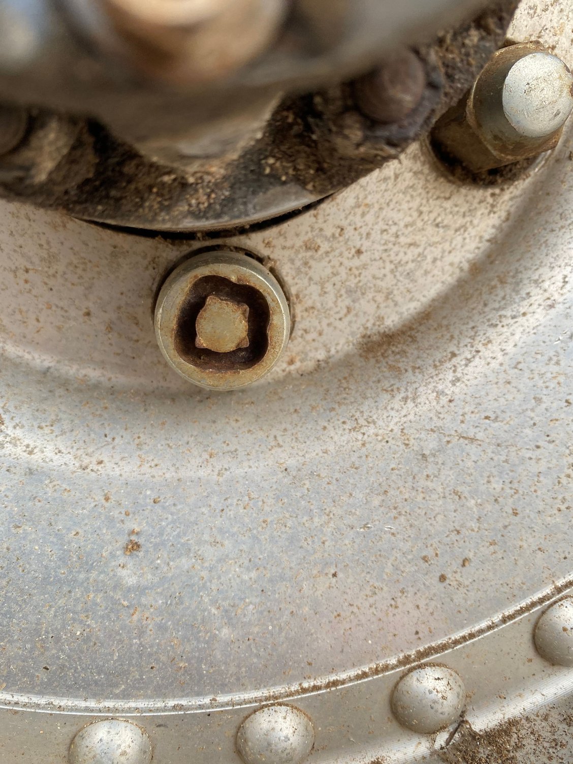

Hey guys! Just picked up an 83 SR5 4x4 pickup. She needs a ton of work but gonna be a great project!
Problem, I bought it with this anti theft lug nut on it. Owner said key is long gone. Does anyone have any idea what this key pattern is? Photo attached.
If not, any tips on what folks have done to get them off? Thanks guys!

Grind some flats on it and put an open end wrench on it.
Weld a nut onto the end of it, ect, ect, ect......
