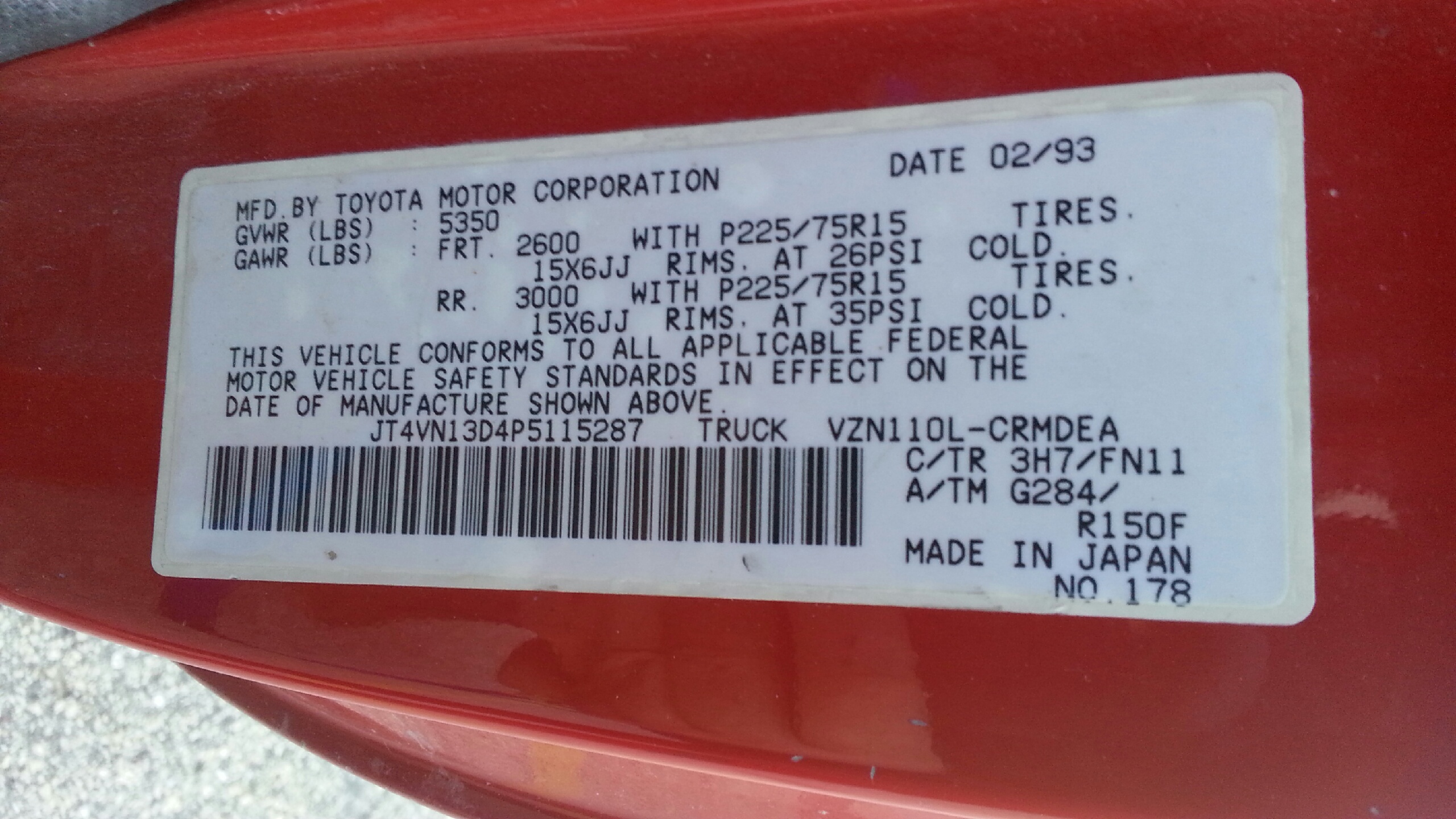

Sorry i am new here 1st post. I tried to Google this for the lat 2hrs still not finding any thing at all. But my truck is a 93 4x4 5 speed 3.0 v6. But my gear code is g284/r150F I want to know what gears my truck has. every thing i looked up said 4.30s. I want to put 31 inch tires on my truck. the tires i have on there now are 235/75/15 tires are old. I just want to know what tires came on my truck stock. if it was 31s or 225/75/15. Thanks.

If it came with alloy(not steel) wheels, then it had 31x10.5s on them. If it came with steel wheels, then it could have had either 225/75's or 31x10.5's on them.
And yes, 4.30's.

I thought that trucks with 31 10.5 15 came with 4.56 stock.
That's supposed to be the case, for 5 speed manual transmission equipped models(autos came with 4.88). But your axle code tells a different story. Which doesn't necessarily mean it's correct. Though in most cases it is.
Why would it come with 4.30s and not 4.10s
Because no 4x4 V6 trucks came with 4.10s in 93.
