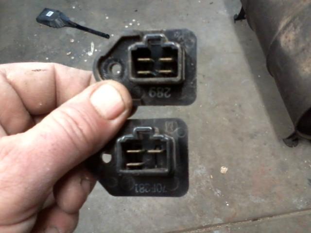

Just incase your lower speeds dont work but highest speed does, I have seen two different types of resistors should you need to replace it. One is a 3 blade resistor and other is a 4 blade resistor. I am not as familiar with the 89-95s but to make you aware of a possiblity. Your blower resistor will look like one of these and is located in the blower assembly.

Thanks a lot turns out the blower only works on medium speed.Now I know where and what to look at.

Since your blower is working on medium speed, I would suspect your fan speed switch as a possibilty also. It is possible that one of the coils in the resistors is has turned to powder. When you pull it out, it will most likely disintegrate on you.
