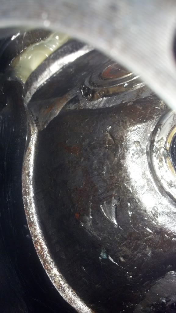

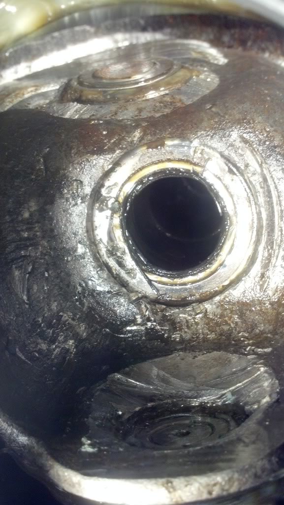

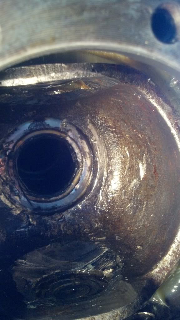

Ok well I got it all sorted out tonight. Maybe you guys can help me out a little bit with something else? I have everything on the short side of the axle taken apart and just got done cleaning. I drove it home after I broke the birfield and now the inside of the knuckle housing? is scraped up pretty bad from all the loose metal going for a spin cycle on the drive home. Should this housing be replaced or will it be fine with enough grease in it?

Ok heres a few of the damage. And one of the birfield just for the lolz, but please disregard the shredded axle seal and beat up bearing as I'm already planning to replace them now
So... hows it look? Give it to me straight doc.

theres nothing wrong with that housing just get dremile and clean it up as good as possible and as to where the seal goes use small dremile head thats for sharpening then use the small buffer wheel just get the burs off and if it made hump spots in there"where the seal goes" get those down as close as possible and when you put the seal back in just lightly coat the outside of seal with black glue. this is very common issue but never a reason to find another unless it wallered out the hole

Good advise but black glue? Rtv ish?

ya me and my buddies just use the black gasket glue in the metal tube.you know theres blue glue and orange and black. the black is high temp and not as spongey you just need to put a little thin coating around the outside of seal just to creat a better seal cause i'm sure it will not be perfect. i've done this alot and never had a leak. both sides of mine have been that way for years

dont forget that usualy when the axle breaks it knocks the diff oil splash guard loose its right behind the axle hole check in your housing real good cause alot of times it if it breaks it slides off the axle in the housing when you pull it out and you never see it. it will eat up your ring gear check good
