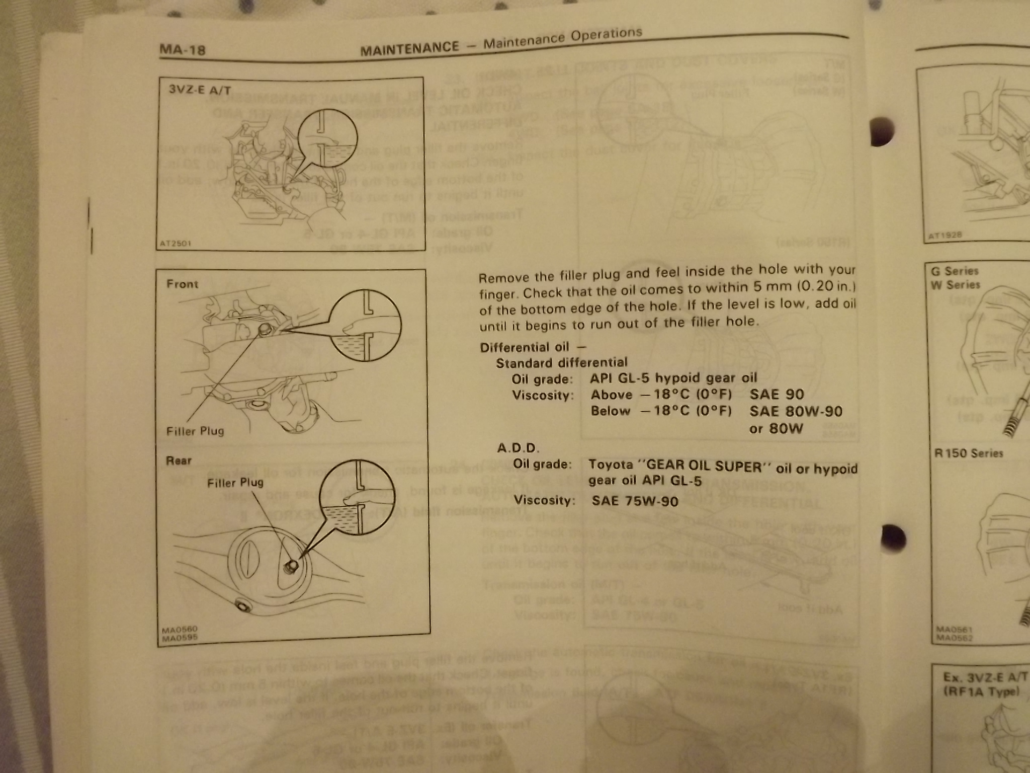

Not familiar with the 95, but for most differentials, you check the level by removing the filler plug and sticking a finger in. The oil should be just to the bottom of the fill hole. Unless you have the front diff engaged, I would think it is safe to drive, but checking the level and refilling as needed is pretty easy, though the fill plug can be in pretty tight. I think mine takes a 21mm socket.....and if you decide to drain the diff oil, suggest removing the fill plug before removing the drain plug.
Attached Thumbnails Front Diff Seal (Couldn't find an answer through search)-dscf7460.jpg

Thanks for the help and the picture. Much appreciated!
