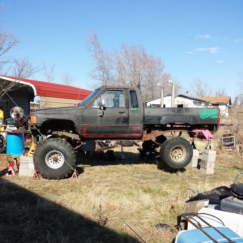

That says also that you moved or deleted the photo? Make sure your using the right image tag.
Definitely has a "mud truck" suspension... Haha. Holy blocks.
Marlin sells a great front end rebuild that uses very good quality bearings and comes with new shims. But I would take your apart first to make sure thats really the issue. The steering arms should not effect how the wheel rolls...
