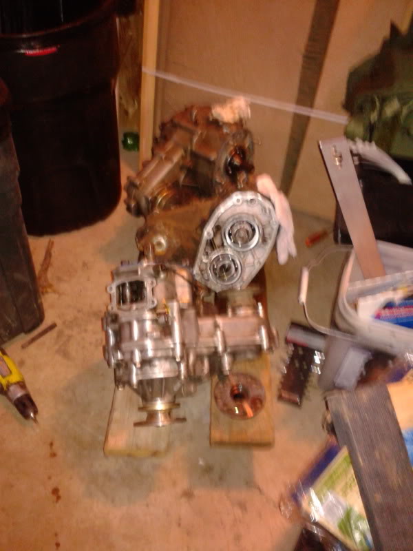

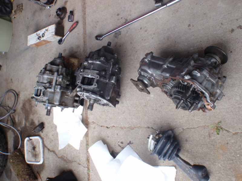

so my truck somehow went into gear leading to my destroyed transmission and case. Yep, I screwed up and it was an expensive lesson, I will always pull the rear shaft instead of being lazy
transmission spline coupler shouldn't come out when you disconnect the T/C from transmission

here is what the input looked like
i frigging hate working on T/C's
