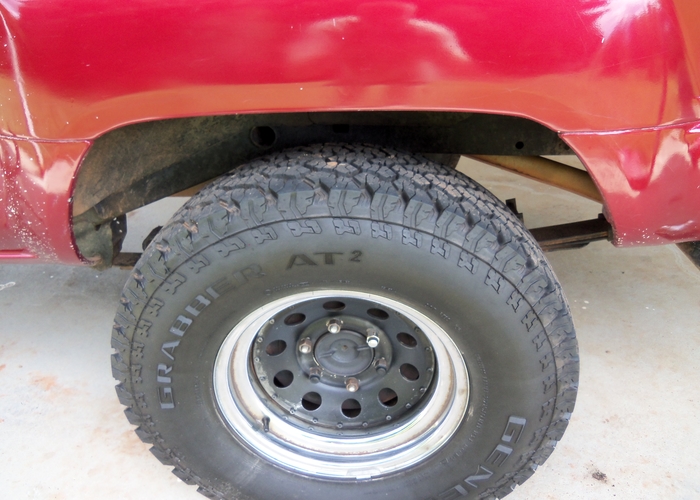

I bought an 87 4x4 pickup about 2 months ago, I've been fixing it up, just replacing old/faded parts to sharpen it's looks a bit, tail/headlights,blinkers, grill stuff like that.. got to admiring it and noticed the Left Side being lower that the Right.. broke out the tape measure and measured from edge of wheel well to the top of the rim, this is what I got.
(L/B) 11"... (L/F) 11 3/4"...(R/B) 12 3/4"...(R/F) 13"... Now, I dont know a whole lot about this kinda stuff but have been tryin to learn more reading up on this site for a few hours each day.. will a "Zuk Mod" fix my problem for the rear?.. or will it still be uneven..should I just replace the Drivers Side leaf spring & throw some new shocks on? Maybe adjust torsion bar for the front? Let me know what ya'll think is wrong with it and how I can go about level'n er out.

Left
Right

with the measurements you took, sounds like the problem is your driver's side leaf spring, and that' it's 2" lower than the other side - which is also contributing the the opposite corner being higher (front passenger). if you're replacing leaf springs, you should do it in pairs ideally. i'm doubting a ZUK mod will help since the coils assist the leafs - and they would be assisting unevenly since the two sides are so different. You could try it first though if you have access to some cheap coils.
cheapest fix would be some used leafs - which will most likely be saggy and most likely only like $20. you could improve the pack by adding more leafs though to get more height. you could ZUK the new used leafs or even add airbags, add-a-leaf, longer shackles, etc etc. For a true fix, your best option is new leaf springs. They will run around $300+

Ok, That sounds right, looking at the right leaf spring it does look newer than the left, like it's been replaced not to long ago, and is not near as flattened out at the other side. I'll definitely go with a new leafs, it's pricey, but I'd rather do it up right since I plan on keeping this truck for a looong time..lol... Thanks for the help!
