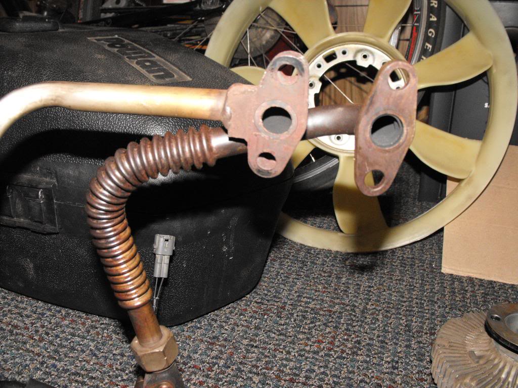

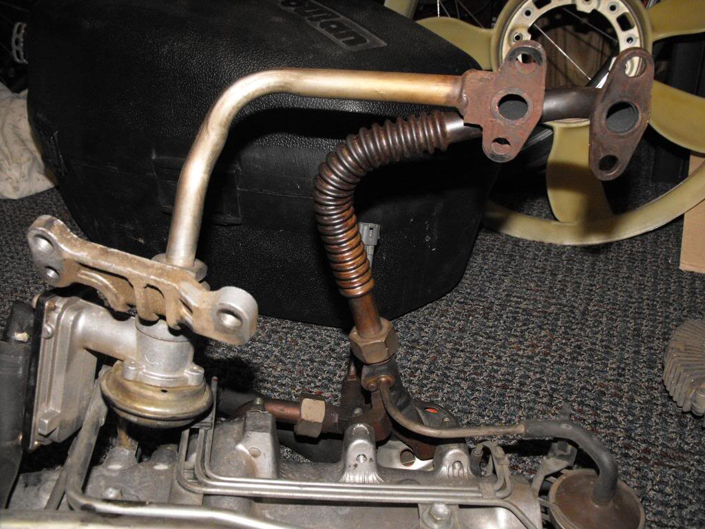

Do these to connections use the same size gasket ?
I can find the EGR gasket on Rockauto, but not the other.

Yes, Its a metal plate gasket, With a little tab on one end.
Get them at Toy or you can cut one from a coffee can, Don't use aluminum as there is a lot of heat and will deteriorate fast.

Thanks, I'm good at cutting sheet metal. I have a nice pair of Wiss snips.
