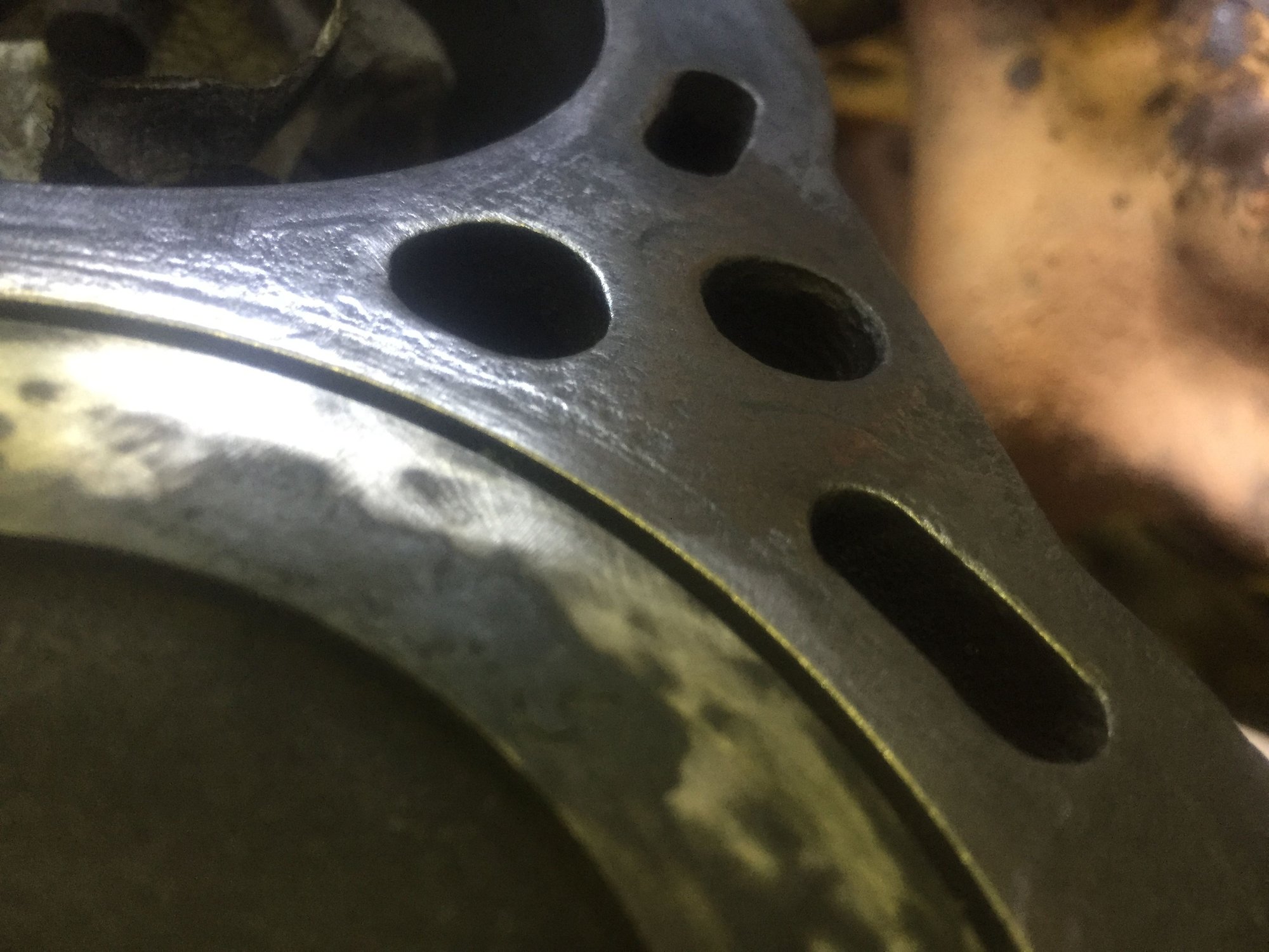

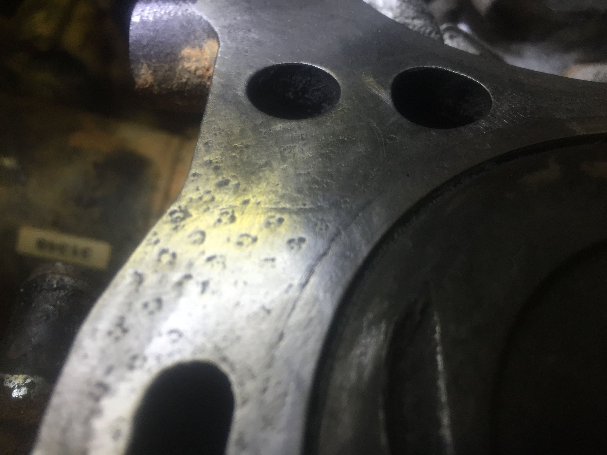

[QUOTE=fierohink;52334063]I have bought an empty head and a dressed head from engnblr. The empty head was due to A crack between valves and I reused my internals.
here is my engine block. Should i get this resurfaced?

Old Sep 12, 2016 | 06:36 AM
fierohink's Avatar
Joined: Apr 2005
Posts: 1,436
Likes: 95
From: Frederick, MD
I would hit the deck surface with a scotchbrite pad and be done with it.
