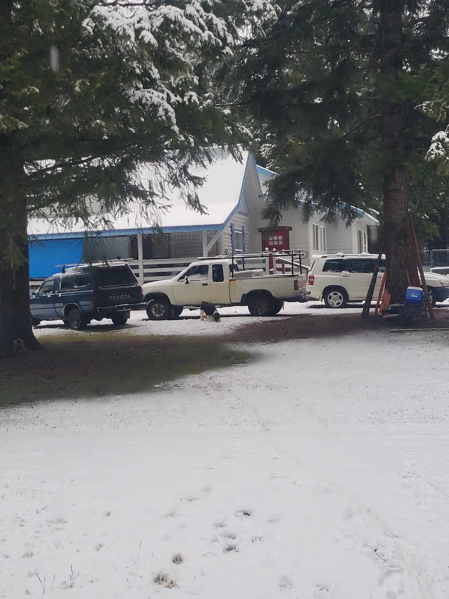

The white truck is my 3rd 94 and green truck is #4

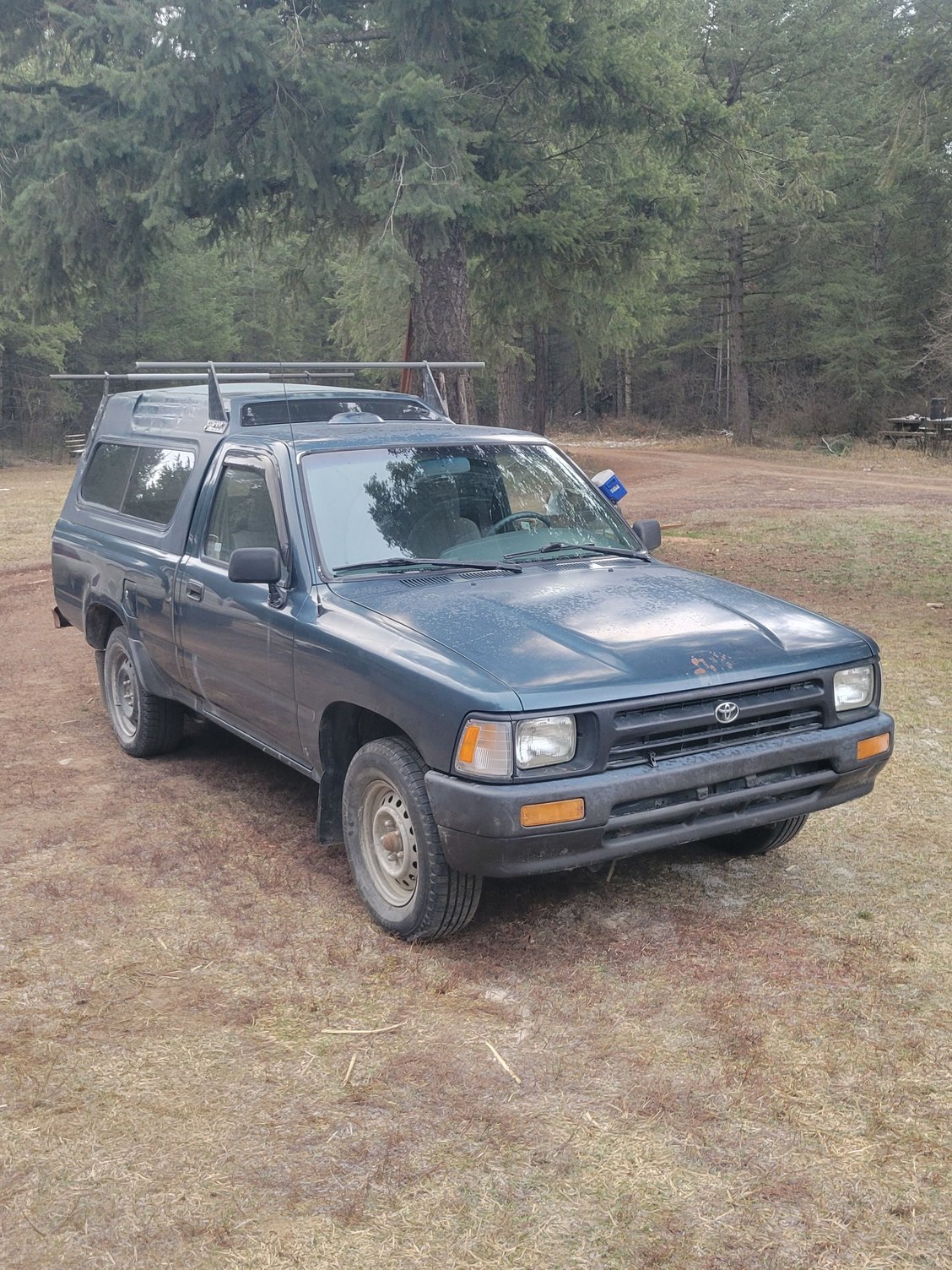

Mines certainly what I'd call a base model except it does have AC. So I'm hoping that the wire is there to plug in. I'd have thought the clutch start cancel would be built in to every truck but apparently not. 😏
