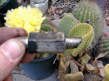

So I pulled my 82 22r and found some clutch issues inside the trans.
Looked in my manual but cant find the proper name of this part. Some sort of stand off that restricts the travel of the throwout bearing and clutch fork.
You can see in the pictures that the clutch fork was rubbing the trans housing. I assume that this little standoff had a half semi circular knob at the end that the clutch fork rested on. The truck had a weird feeling clutch, the dis-engagement was very limited. I think this was causing the Clutch slave to have limited travel. The knob was off in the engine side of the dust cover, Along with some clutch fibers.
Anyone know what this part is called and who might have one for sale (in case I cant find a used one)
