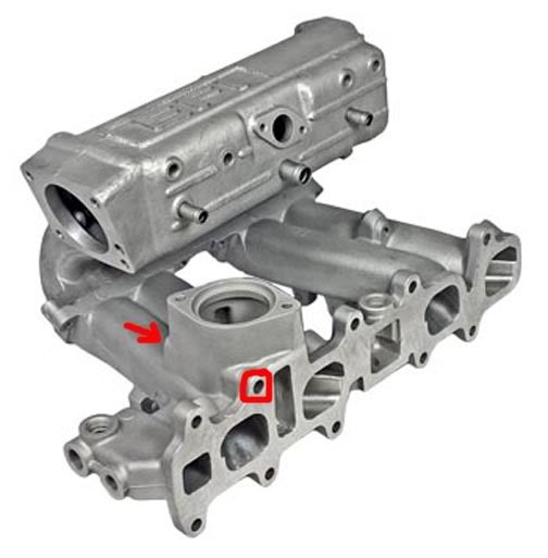

@pismojoe thanks for the graphic, i have a feeling thats what i got hung op on last time...

okay, about the "4 bolt seam on the pipe thingys" if you take the arrow pismojoe drew on his graphic and turn it backwards, it will point at "the seam thingy" i was talking about
I don't know what 'seam thingy' you're talking about lol
Try to explain it better, the EFI plenum has 2 parts, the top box and and the bottom manifold. Is it on the top part or the bottom?

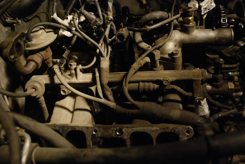

Can you see it here?

yes! okay, im gonny try to use the actual words. in the photo you removed the top box from the bottom manifolds. that was my question.
long question short, can i remove the top box but leave the lower manifolds installed.
and the answer (wich i just figured out) is yes, the top box and lower manifolds are two different peices and can be seperated, they are not one peice.
