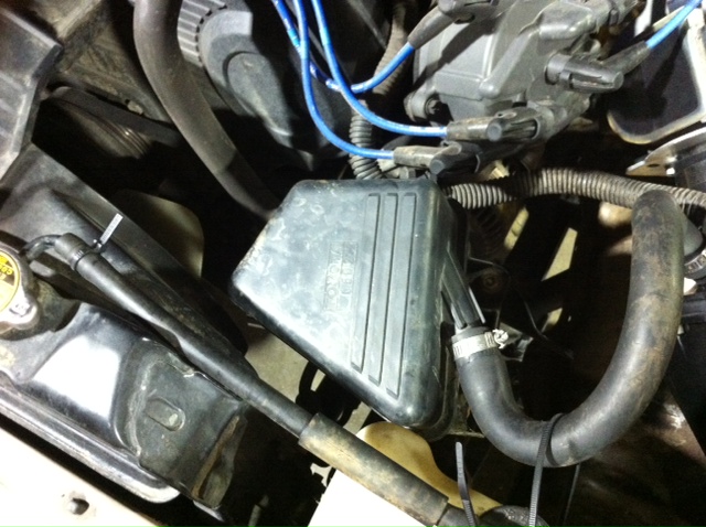

Can I get rid of this?
Officially it's called the Upper Intake Silencer in the FSM... What does it do? It has a hose connecting it to the intake on one end and another hose connecting it to a vacuum hardline. Can I pull it and just run a straight hose?

Its the PAIR silencer, You can remove it and run the hose straight across or as some do eliminate it and put a filter on the pipe coming out font of the intake manifold.
This is noisy though.
