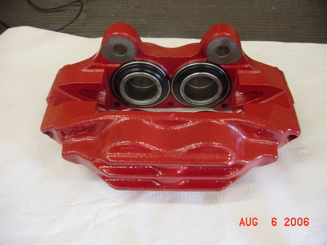

The calipers on my 4cyl and the calipers I took from the 6cyl both look like this:
Old Sep 25, 2009 | 07:45 AM
BigBluePile's Avatar
iTrader: (3)
Joined: Dec 2006
Posts: 15,192
Likes: 190
From: Sedro-Woolley, WA
Then either somebody upgraded for you OR they started coming that way. Regardless, you should get the dual diaphragm booster. That was the biggest improvement in the brakes for me.

I'm the 2nd owner, and the PO didn't mention any brake upgrades. That, and the fact that the part numbers match at RockAuto would make me think that it came off the line that way.
Interesting. Looks like I've got some nice calipers to sell.
