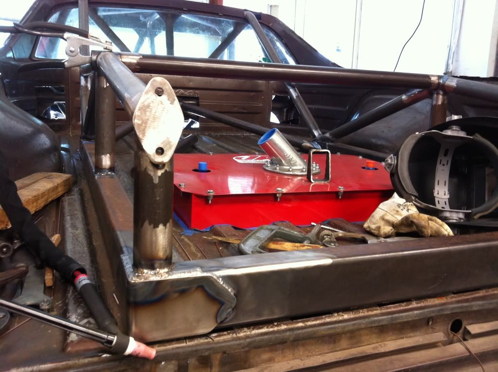

PS if you really plan your build, you can do quite a lot without a bender. We're building this full chassis Camino at work and there is only about 15 bends in the entire chassis.
No bends in the bed cage at all.
