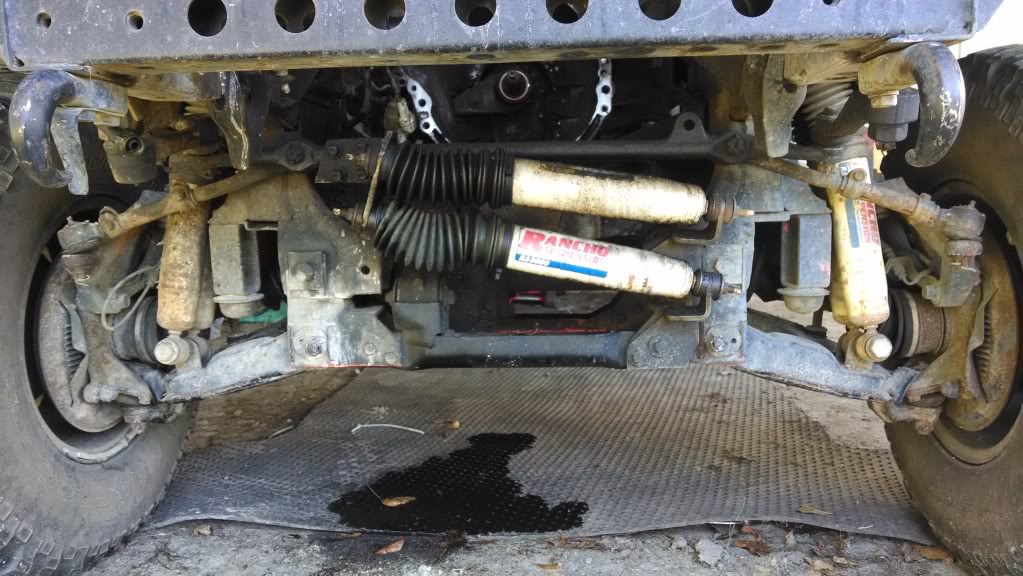

Im also not sure what the lift is but IT has duel shocks and steering stabilizers. (no engine in truck at the moment) Thats why the front angles are so bad Name:  IMG_20131119_125611855_zps4c3fb12b.jpg

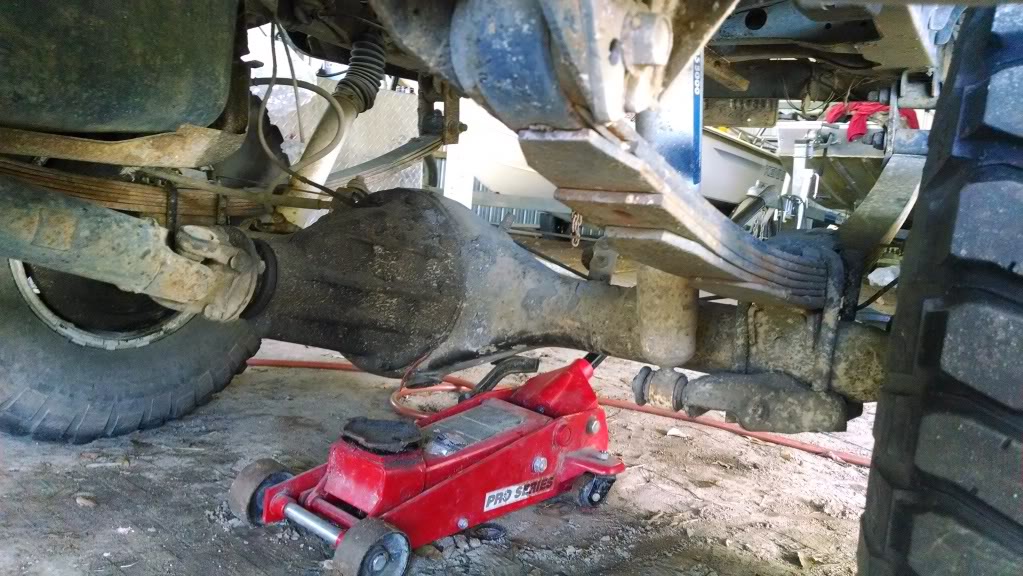

Here is a pic of the rear springs

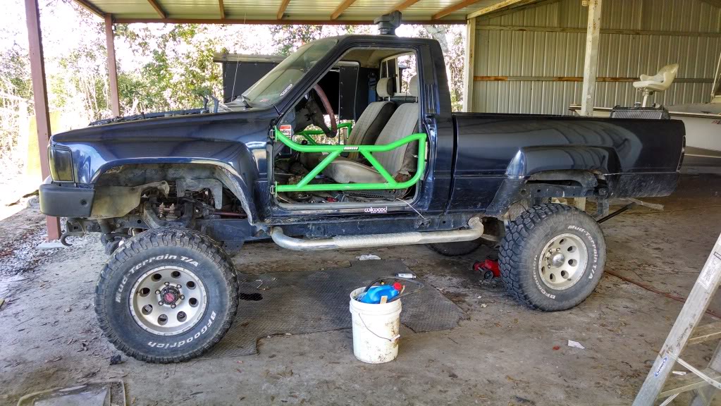

Then a side shot to show ride height. Its sitting on 32s at the moment. also has a 3 inch body lift. (hate it)Name:  IMG_20131119_125752842_HDR_zps492fa2a6.jpg

when it's back up and running, i would try messing with your rear leaf pack, try removing a leaf and see how it feels afterward - this will also lower the rear. in the front, get back to only one shock on each side as duals aren't helping the plushness. you can try to relax the t-bars, but they will always be stiff until you add more weight up front (like winch + steel bumper), perhaps swap them for stock ones. you will never really be able to lower it enough to get CV's flat.

I second what the Potteryhead said. The rear shackles look to be about stock length, so remove a leaf and add a longer shackle if you need the lift. Kind of looks like that square cut leaf is added for possibly an overload or more lift, so I would lose that one first. And back those torsions off a bit. Lose the dual shocks on the fronts.
