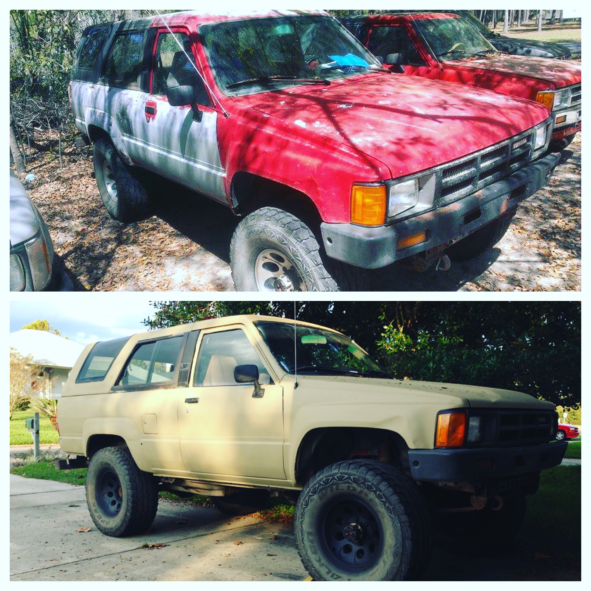

Alright so I've actually been working on this swap for about a year just gathering parts and money for my early model 85 4runner. Now I am very close to getting everything together. I have a good 4.3 vortec motor from a 99 S10 that I got for only $125, I picked up a R150f and have all the adapter parts from advanced adapters including motor mounts, toyota gear driven tcase (with adapter), I have a computer and wiring harness from Howell harnesses. Im currently looking into the radiator which I found out would be 19x22 (which should be easy to find). I know I will have to change out hoses with this swap but the thing I'm having a hard time finding is more about which fuel pump I can run and just get a regular fuel filter and make it work. Also which fan to run (part numbers please) and can I still use my stock fuse boxes or would I have to go get some from a 99 S10 or blazer? I'm on the final stretch of this swap and just need some advice. So to sum this up my question is what fuel pump to use (if I can use 22re stock pump), fan part numbers, and what do I do about the fuse boxes?
