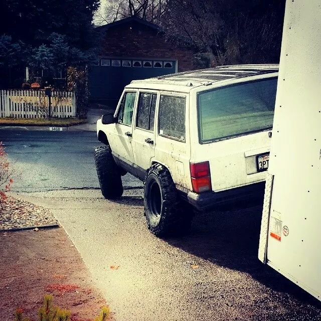

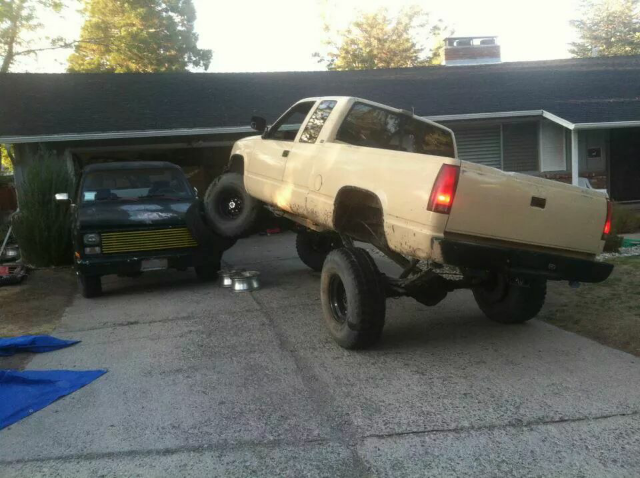

Here are some photos of my old rigs
These are all I could find before work
Attached Thumbnails The Age Old question!! SA vs. IFS-forumrunner_20140909_171220.png   The Age Old question!! SA vs. IFS-forumrunner_20140909_171246.png   The Age Old question!! SA vs. IFS-forumrunner_20140909_171238.png   The Age Old question!! SA vs. IFS-forumrunner_20140909_171229.png
