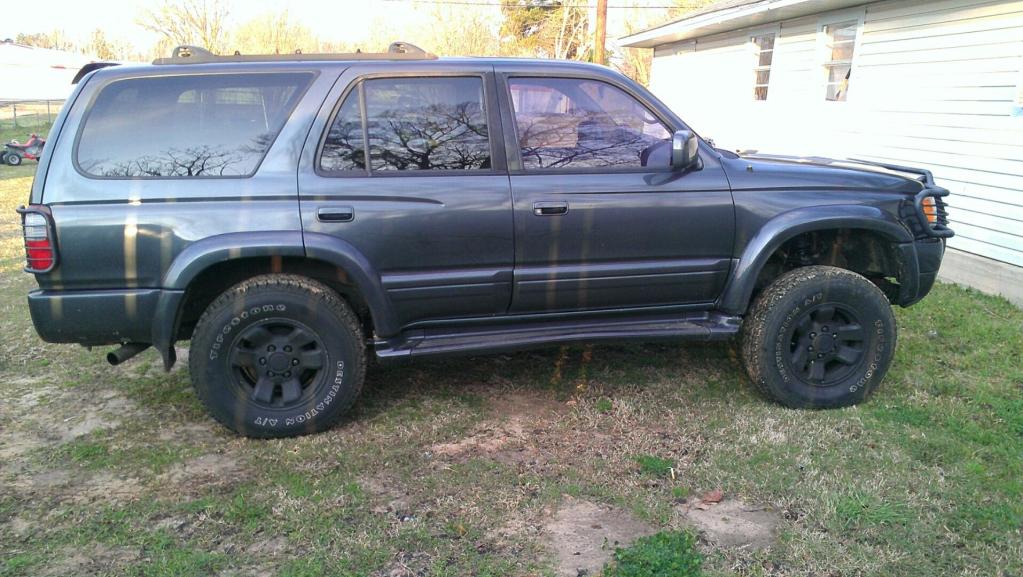

Old Feb 15, 2013 | 08:04 AM
Grey's Avatar
Joined: Feb 2013
Posts: 20
From: Tyler, TX
Old Feb 15, 2013 | 08:07 AM
JBurt's Avatar
Joined: Jan 2010
Posts: 953
Likes: 21
From: Imperial County CA
The front looks about right. What the measurement from the center of the hub to the top of the wheel well on the rear? For example with my OME 2" lift I've got 24" on the rear. Can't tell you what the front is because it's torn apart right now.
Old Feb 15, 2013 | 09:17 AM
Grey's Avatar
Joined: Feb 2013
Posts: 20
From: Tyler, TX
You were right about the front, it measured 24". The back measures 20". So the back is my problem and i have no clue.
