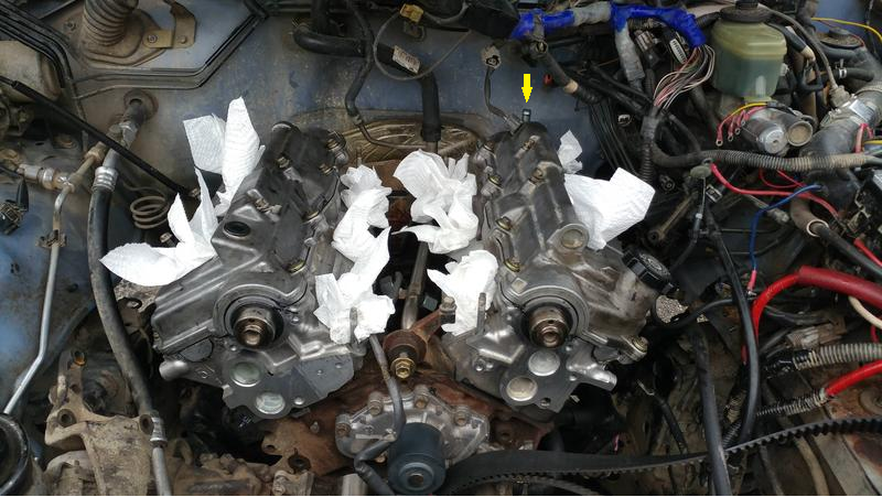

Hello all, I’m in need of a little help I have one vacuum line I can’t find a home for anywhere. It’s the bigger metal line bolted to the top of the intake manifold, on the drivers side the passenger goes into the intake tube.
If anybody could point me in the right direction I’ll be very appreciative.

If it's the one I think you mean it goes down to the nipple on the rear of the left (driver) valve cover (looking at back of engine...
yellow arrow at the rear of the valve cover...

Am I blind I can not for the life of me find that nipple

My 96 is a 5vzfe in a 4runner....yours is a ?

96 T100 but it has a 2001 4Runner motor

I found it!! It’s a 90 degree nipple and somebody grabbed it off the motor I pulled from the junkyard before I got there, so I pulled it off my old motor and slapped it in there.
Thank you for all the help and replys
