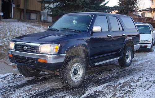

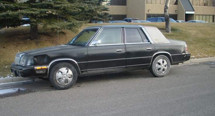

I just bought a '95 4Runner (automatic) from work for 1,500 CAD and retired my '86 Chrysler New Yorker. Thats right.. '86 Chrysler New Yorker complete w/ black stallion front license plate, glossy black spray paint job, spinning hubcaps and a disco ball which is of course now in the runner muahahah.
I know all you guys are into offroading and that sure sounds like fun but before this is an off-road vehicle, I want to make sure its a good on road one. I don't think the guy who owned it before me took care of it very well, I got an oil change and replaced all the regular fluids (tran/power steering/brake). After having it only 4 days I got a flat about 100ft away from guess what.. a Toyota dealership. Since it didn't have to tool to get the spare down i brought it in and had them switch it for me. They noticed there was a recall on the front steering link and fixed that for me but also found (surprise) that I needed front brakes, new bearings and adjuster sleeves. All of that would come to around $700 CAD for parts and labour.
My questions are:
1. I think i got a great deal on the truck.. interior is great some rust around fenders, appears to have been bondo'd as some point in time. Do you think its a good deal? b) i was planning on sanding the rust out, priming it and putting some sort of plastic guard over the wheel well, is that a good idea? If not how do i get rid of the ugly rust?
2. Should i always go to the dealer for repairs? My friends are telling me I can get that work done considerably cheaper elsewhere. b) are there some things that i should absolutely go to the dealer for and others i can outsource?
3. I read about a head gasket 'recall' campaign.. what is that? Should i be concerned about it? The dealership didn't mention anything
4. Any other advice you could give me to me as a VERY excited but inexperienced new yota owner would be appreciated.

Hey Friend, welcome to Yotatech!
1. To really get rid of the rust for good, you will need to cut out the metal thats rusted, aswell as the metal thats very close by. You can get metal replacment fender lips from www.toyotafiberglass.com You weld them in, bondo, sand, prime then paint.
Its alot of work, but thats the way you do it right.
2. I hardly take my truck to the dealer, partly because I have it in for the manager, but mostly because they charge so much. Personally, find yourself a mechanic, talk to people that have had their cars worked on by him. I take my truck to a mechanic that works out of his house. I usually stick around and get him to show me how to do the work.
3. The head gasket recall was for the 3.0 Due partly to the gaskets used (toyota had to scramble and get a gasket that didnt have esbestos in it, around 1988). If you do to the toyota dealership with your vin number, you can find out if your truck has had it done, or is even elegable. Most 1995 trucks/4runners where not included in the recall.
4. For some general tips and stuff.. I would suggest you pick up a set of Aisin manual hubs, they replace the A.D.D hubs you have now. You can unlock them in the summer and that will reduce a TON of wear on your cv-joints.
You might want to change out all your drivetrain fluids, most people forget about them, not good.
