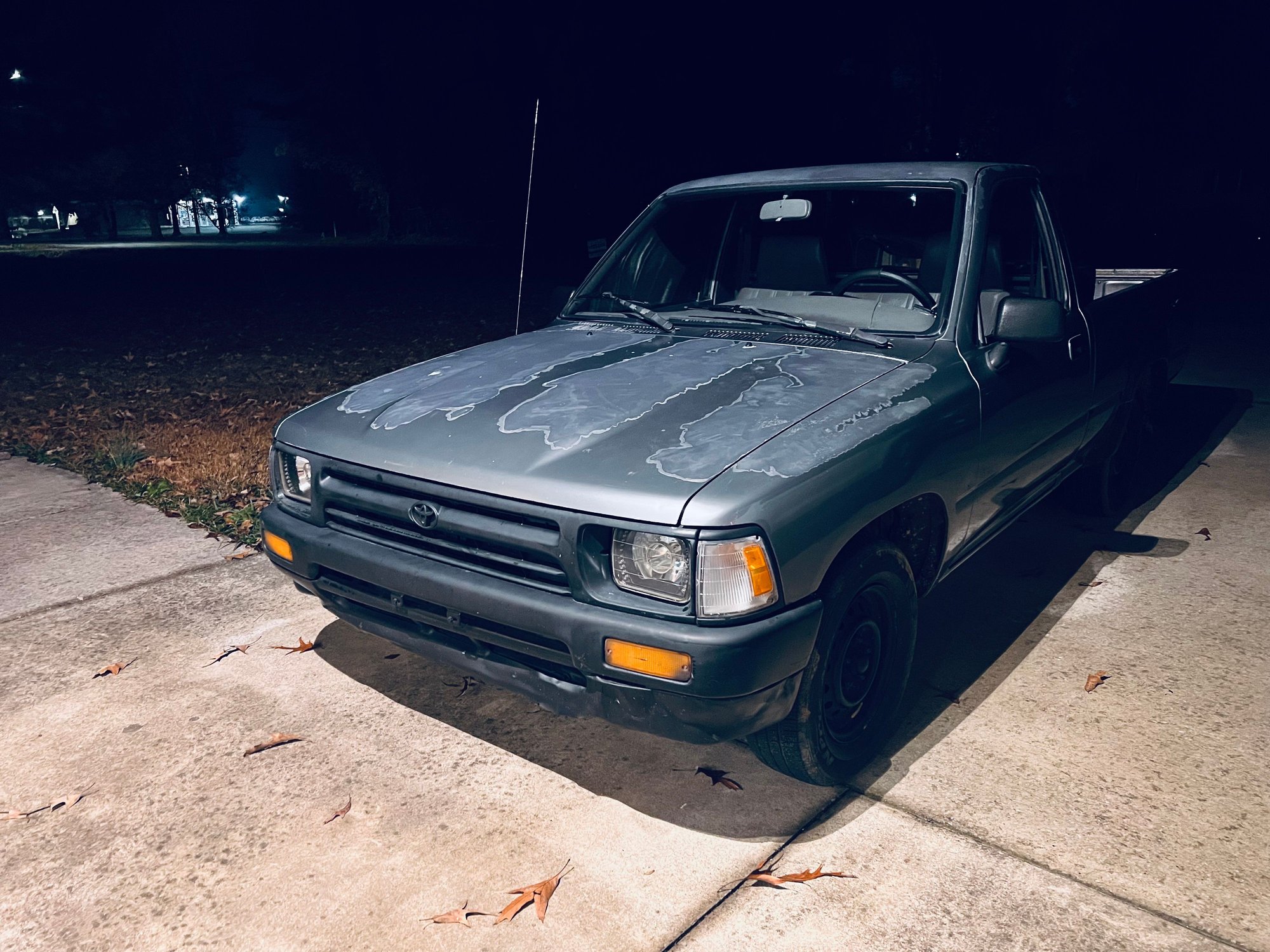

I bought a 93 Toyota Pickup 22re 2wd with around 200k miles. It starts and runs pretty good, but the temp guage barely comes off the cold mark. And the other issue is that the idle seems ver low and sometimes unstable. Im suspecting the heating issue may be the thermostat stuck open was just wondering if anyone else has seen an issue like this? The engine gets warm but not what i think it should be. Not sure about the guage as the needle does actually move off cold slightly as it runs. Also could that cause the idle issue as well? The cab heater does blow pretty warm as well.
