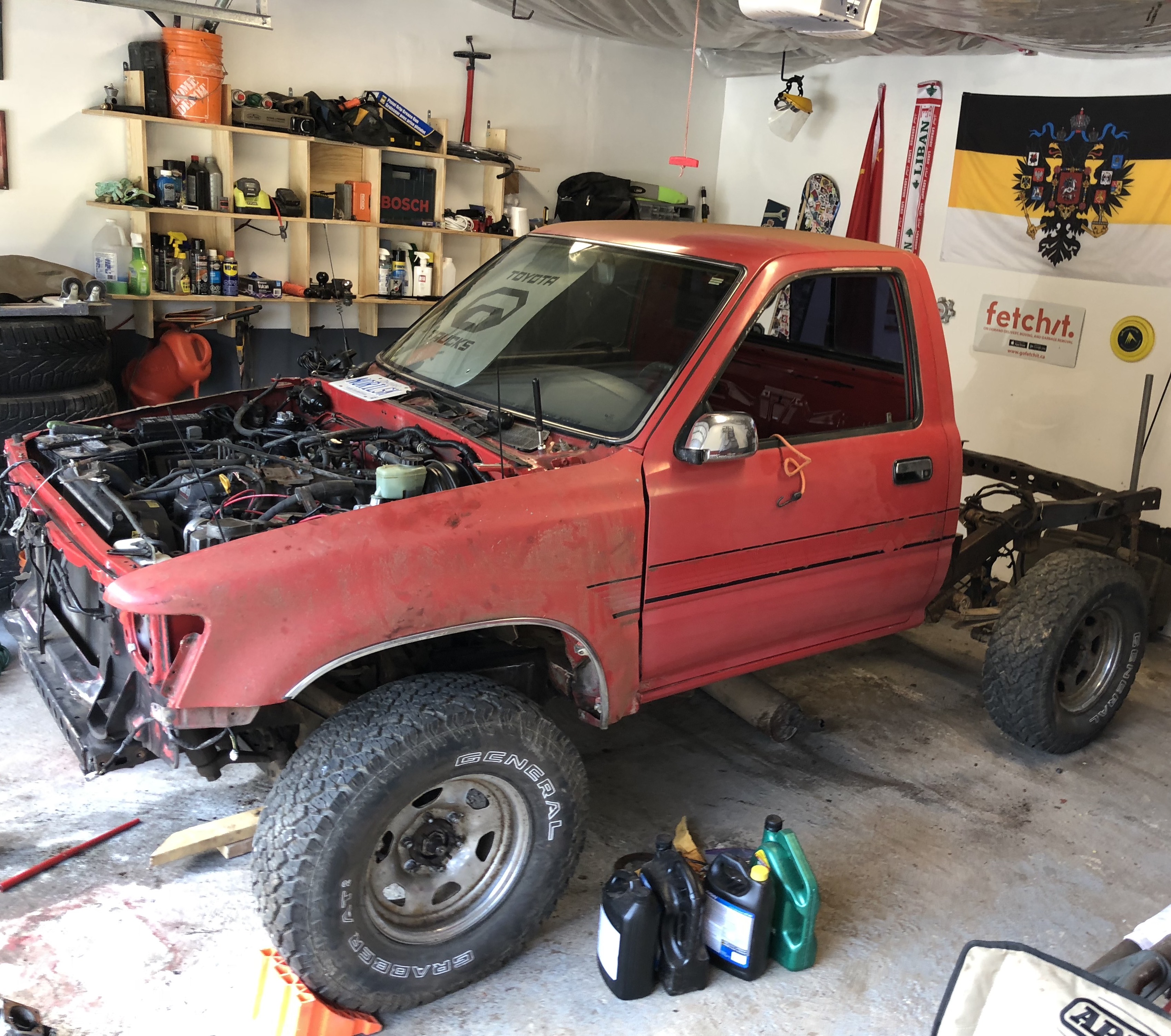

93 22RE can not make it run.
So I realize there are plenty similar questions and I've gone thru most of them here but I still can't solve my problem.
I have 1993 Toyota pick up truck 22RE that doesn't run on it's own unless I keep feeding "quick start" into intake, which would point to a dead fuel pump or fuel not getting, but fuel pump is working and fuel is getting into cold injector.
Things I've done so far:
1. Replaced spark plugs
2. Replaced spark wires
3. Replaced fuel injectors
4. Checked AFM sensor and everything within FSM specs.
5. Checked throttle sensor everything is withing FSM specs.
6. Checked any loose wire and ground, everything is fine.
7. Checked fuel pump B + Fp, fuel pump is working
8. Checked cold start injector, fuel is getting there.
9. Replaced fuel filter.
Things that are shady:
1. Engine light does not appear when I jump the wires - dead ECU ?
2. I opened the top of the AFM sensor and manually moved the lever, can hear fuel pumping, but when I crank the engine it does not move on it's own - dead AFM?
3. Ordered new COR just to eliminate the possibility of a bad relay, this truck was a cottage truck for the past 5 years and sat in the forest, maybe moisture did it's job with that relay given how bad the floors are on the thing that I have to re-do them.
Any tips which way to look and what to check next?
