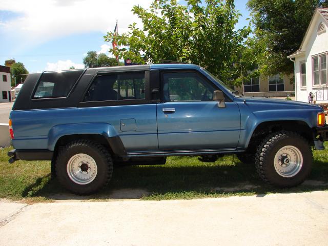

Long story short, have a 89 4runner SR5 with a rebuilt 3.0, new: injectors, plugs, wires, fuel filter, air filter, battery, etc. & rerman: alternator, power steering pump, starter, etc. Roughly $4500 spent in new stuff(all engine related ).... been driving it for a while now 2900 miles... Im only getting 11 mpg mostly back highway driving @55 & 2400 ish rpm. (Rairlley on the freeway, but thats 70mph @ 3000 rpm's) Even took off the AC belt & that uped it from 10 to 11 mpg.
I need it to get better MPG!
I mostly daily drive it. would like to start off roading it weekend outings, camping, etc. (but not @ this lousy of mpg)
has 4:10 gears, manual trans, manual front locking hubs (so I can have it freewheel when on road), 31x10.5 R15 tires (like to keep the tire size, as they have 75% tread) @ 40 LBS. pressure.
Ive tried the jumper wire & never seen any blinking lights.... took out the cat thinking it may have been clogged, but that made no difference. Re checked the timing & its just above 10 degrees... so Im kind of @ a loss...
Also put on a new turbo muffler & 2" tail pipe.... & a bout 2 weeks ago the muffler cracked open(about a 5" x 3" + shaped crack .. someone said it was possibly a back pressure issue?
Anyone have any ideas????

Your truck is a good looker.
With your tires and gears, it should be getting 18+ MPG the way you are driving it.

I think you are just fighting the bad DNA in the ECU. I would very seriously consider the DIY ECU. Oh and lose the tires, get back to the stock 225/75R15's and you mpg's will get better. enough to pay for the tires.
You have a sweet looking truck!
