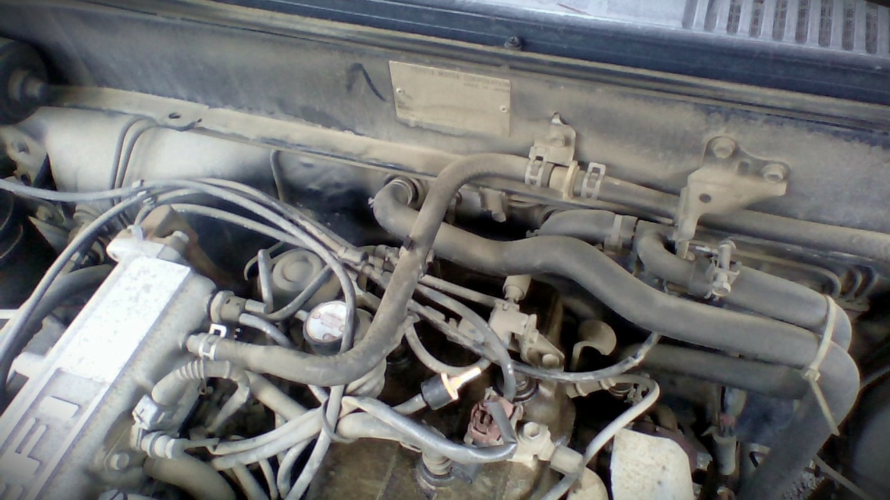

I just need to know what piece this small hose would normally attach to because I have to replace it.
Attached Thumbnails 88 22re over heating and had piece snap off-1412203107438.1.jpg

Uh which hose?

Where the orange tip is showing.

That looks like some sort of vacuum port. Let someone else chime in to where it should go.

I think its a bypass vsv, but i cant seem to find out what the port where it attaches is called.

There should be another vacuum hose that attaches into it. That hose should come off of a red VSV on top of the valve cover
