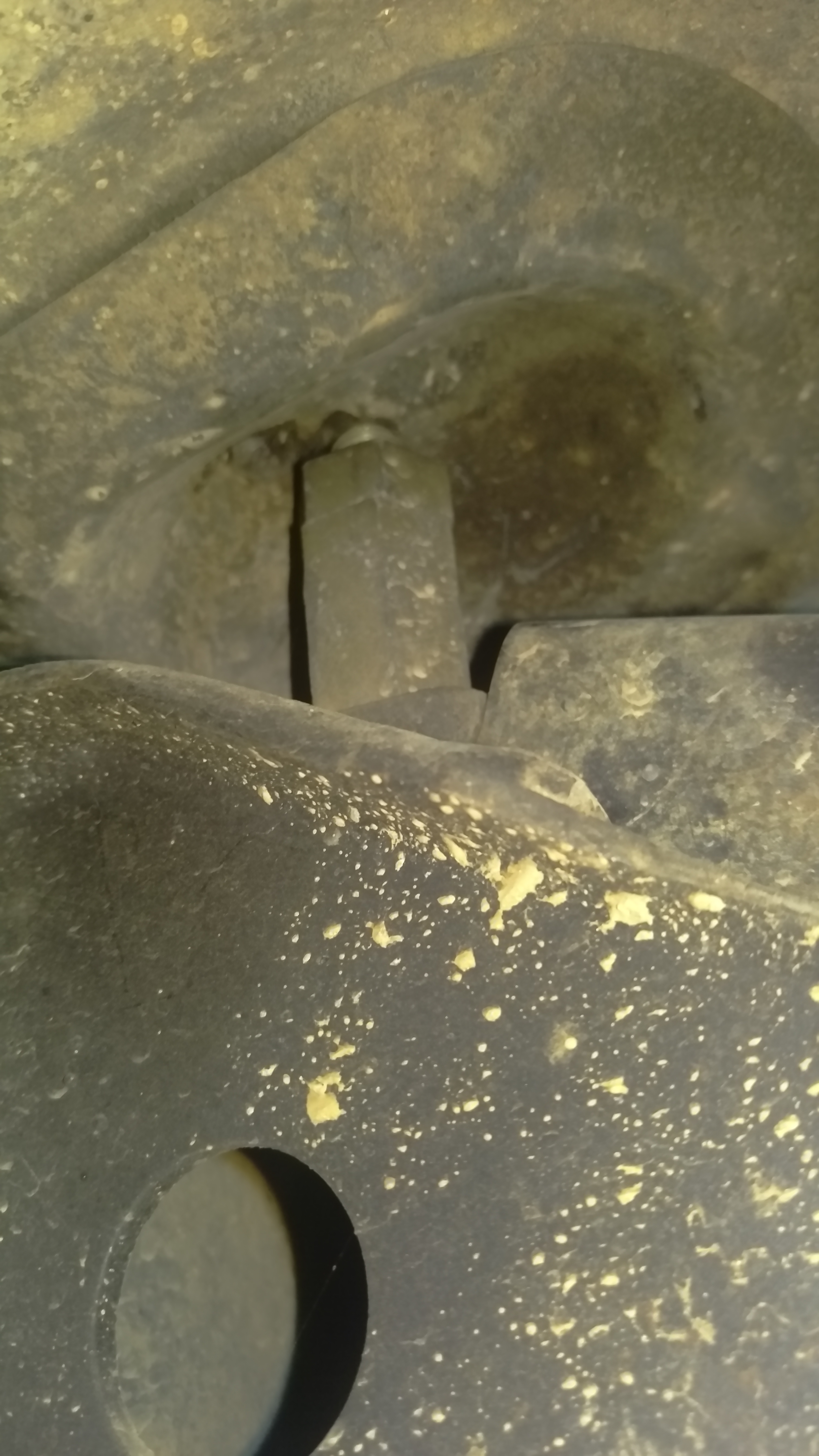

Also while digging around looking for more rust I noticed that close to where the torsion bars mounts towards the back there's some screws that go up towards the body. On one side it is much closer to the body than the other. Is this normal? What are these? (pics to help identify)

Did some more research, only have a phone so kinda hard, but seems those bolts are torsion bar adjustments? Should these be equal on both sides?

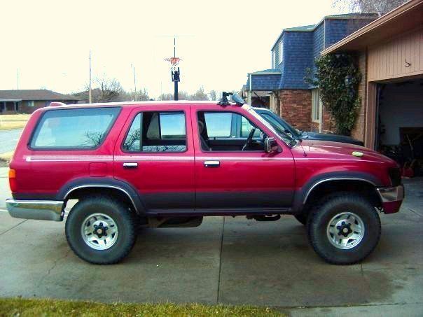

I didn't mean paint the whole truck
If you've got rust in various spots at the bottom, fix, tape, and paint just what you need. Obviously you need to make a nice pattern. Since you've got a some on the roof, you'll do more up there but it'll hardly be noticeable. If you fix more rust in the future, you'll be able to get the same paint and can just expand your repair coat.
Here's an example:
Notice darker color around bottom edges
