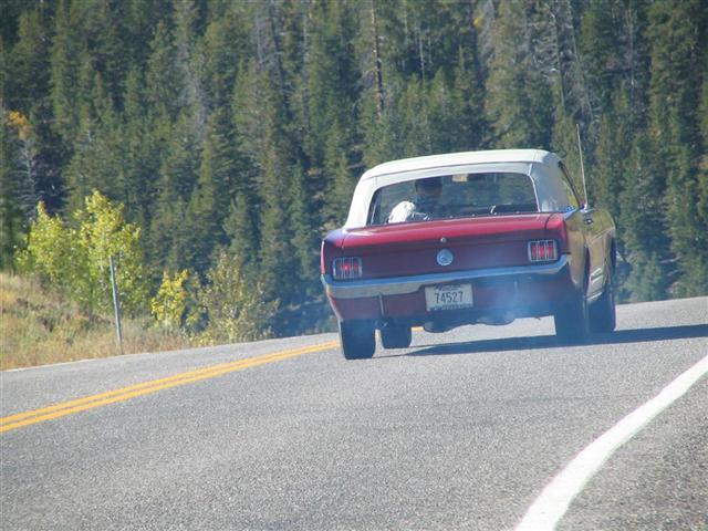

Here are some examples of normal morning white smoke I found on Google:

Here are examples of blueish exhaust (oil mixed in the exhaust)

It is carb'd and it's blueish until it's warmed up
