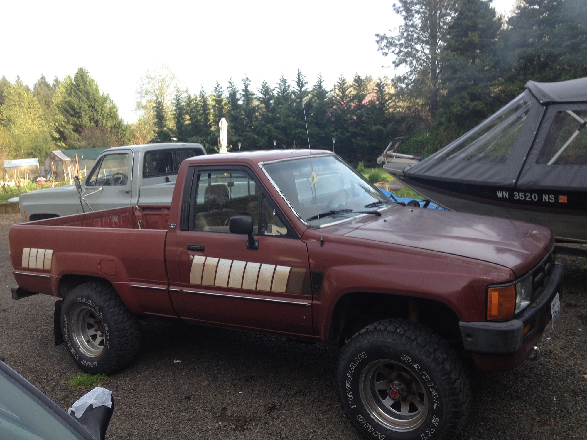

Old Apr 8, 2015 | 03:43 PM
bruno6's Avatar
Joined: Feb 2014
Posts: 12
Old Apr 11, 2015 | 03:42 PM
bruno6's Avatar
Joined: Feb 2014
Posts: 12
so i decided to go with the 63" chevy springs on this truck but what is the best way to go on the front ?
