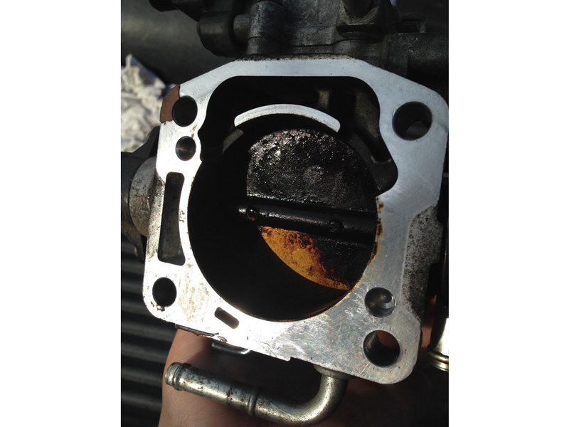

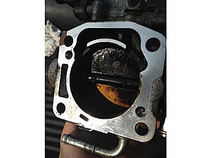

Well, went ahead and cleaned the MAF and the throttle body.The idle is improved slightly, but that could be due to resetting the codes causing a slightly higher idle for the time being. Swapping plugs to see if I can move the code. I'm thinking maybe the new coil isn't OEM and therefore prone to failure? Kinda shooting in the dark . Going to smoke the air intake too, see if I can find any leaks...we will see...
