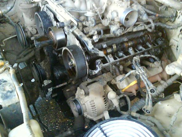

So it took me awhile to find the time to work on her but I finally found the motivation to yank the valve covers yesterday and found that....It was the camshaft! It wasn't broken but the rear lobe is nice and round So now I get to go tear apart the front of the motor and put in a new camshaft, valve lifter so it doesnt eat through my new one and a timing belt of course. Since im gonna have the front of my motor apart does anyone have any routine maintanance I should do while im in there? And does anyone have a link for the timing marks on the 3vz-e? Anyways I attatched some pics so you can see the damage....its the last lobe in the back...as you can see it should be pointing towards the wheel well like the third lobe but its nice and round instead.

Well I got everything torn apart and got the cam out...Anything I should replace before I start buyin parts and puttin everything back together?
