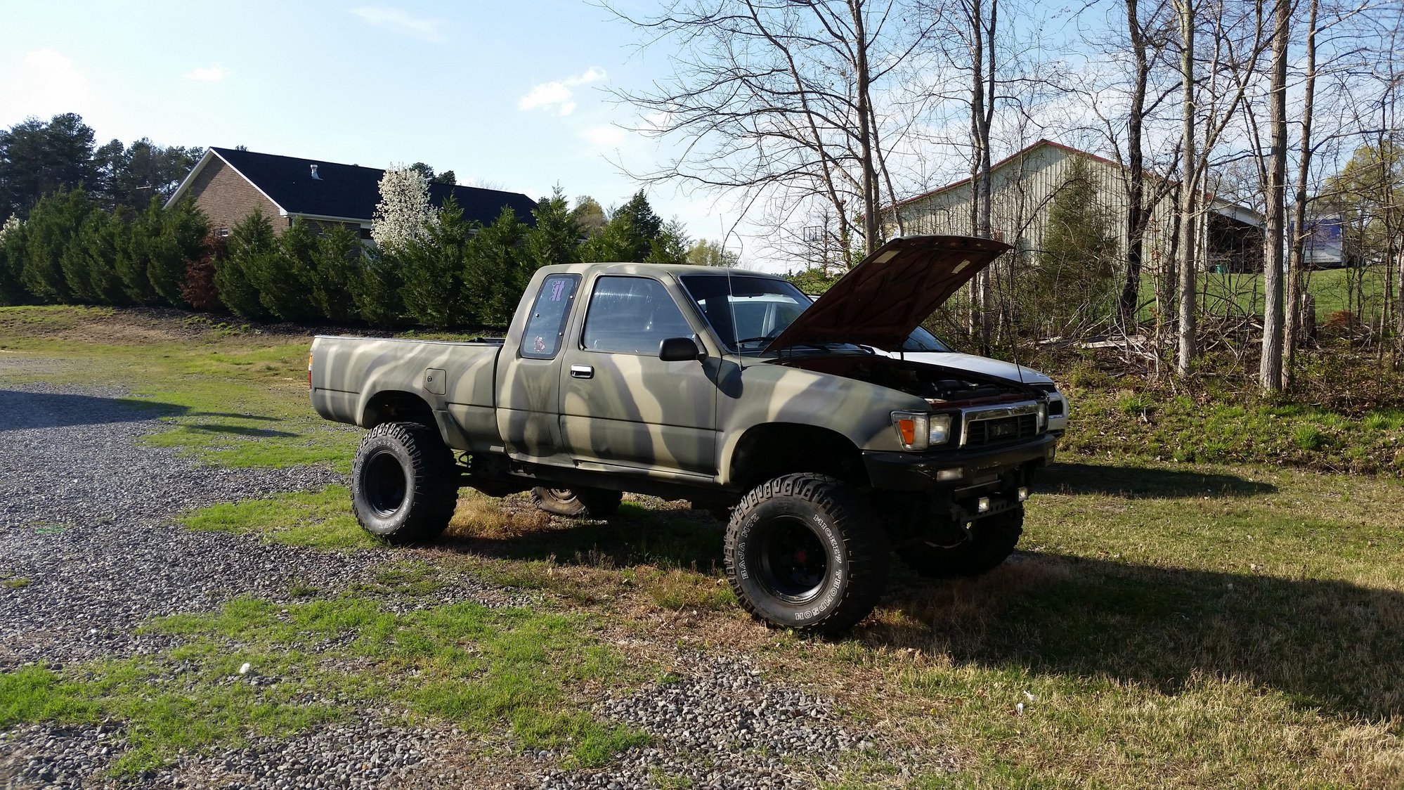

Just bought an 89 4x4 pickup it had two cylinders misfirring the guy said the gas tank had some trash in it not rust but that the injecters were getting stopped up... so I replaced 1 and 2 injecters misfire quit drove it around for awhile and then lost number 1 cylinder again so my question is I saw where the guy had the fuel filter zip tied to the inner fender and its supposed to be mounted on the block would that let trash into the fuel rail?
Any help would be greatly appreciated btw I only paid 900 bucks for it 176xxx miles
