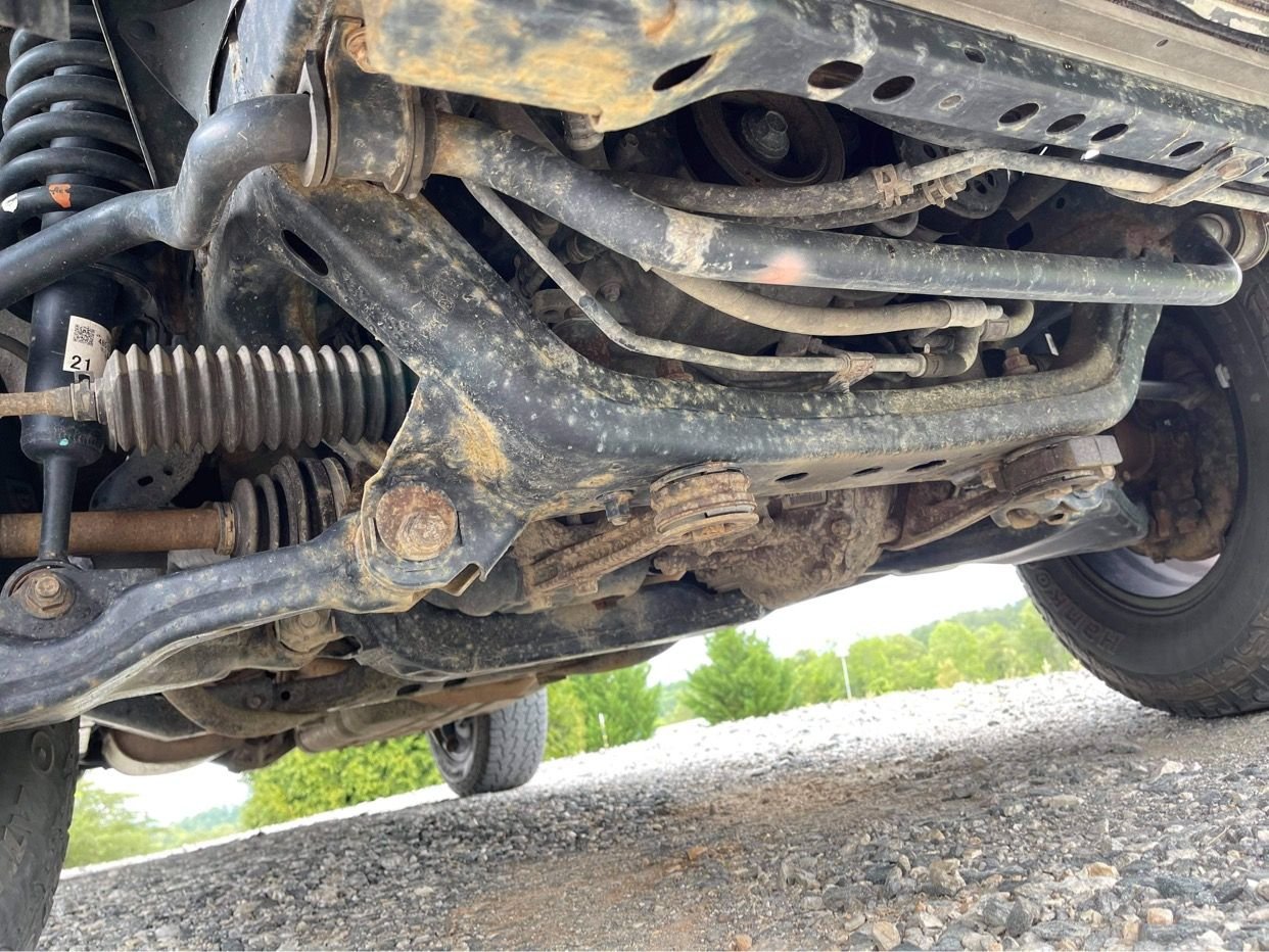

Hello all,

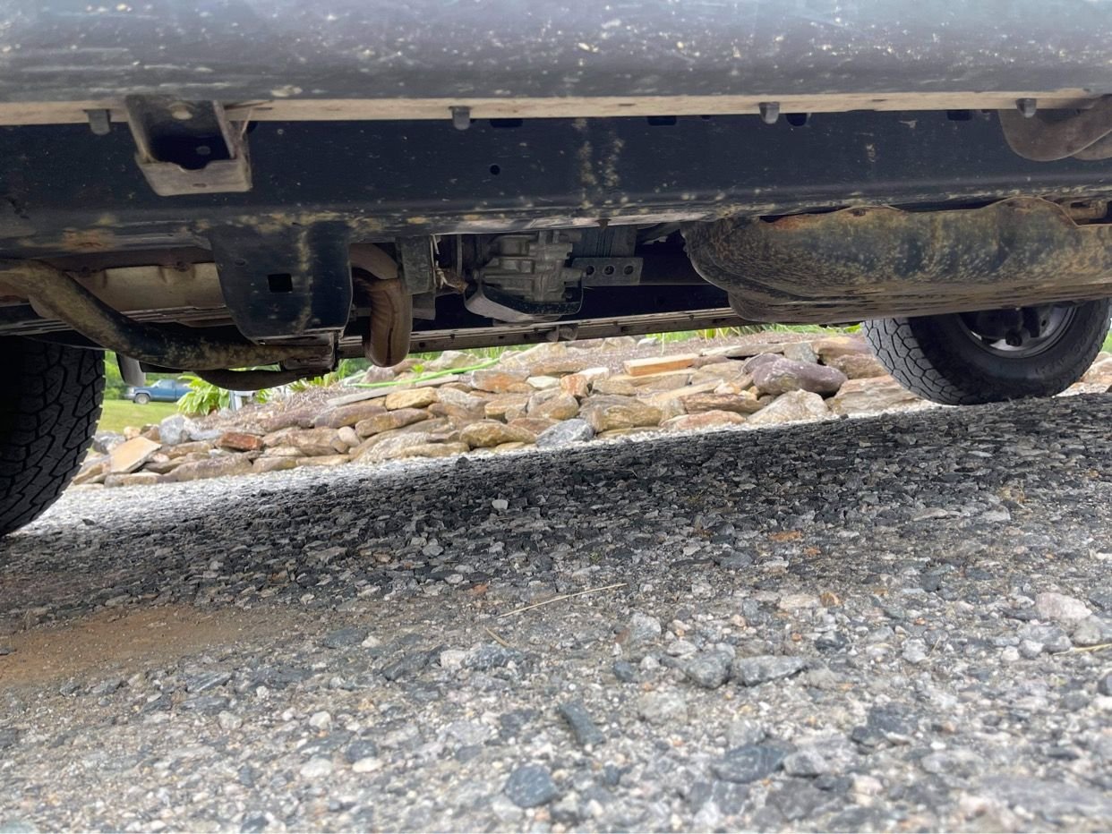

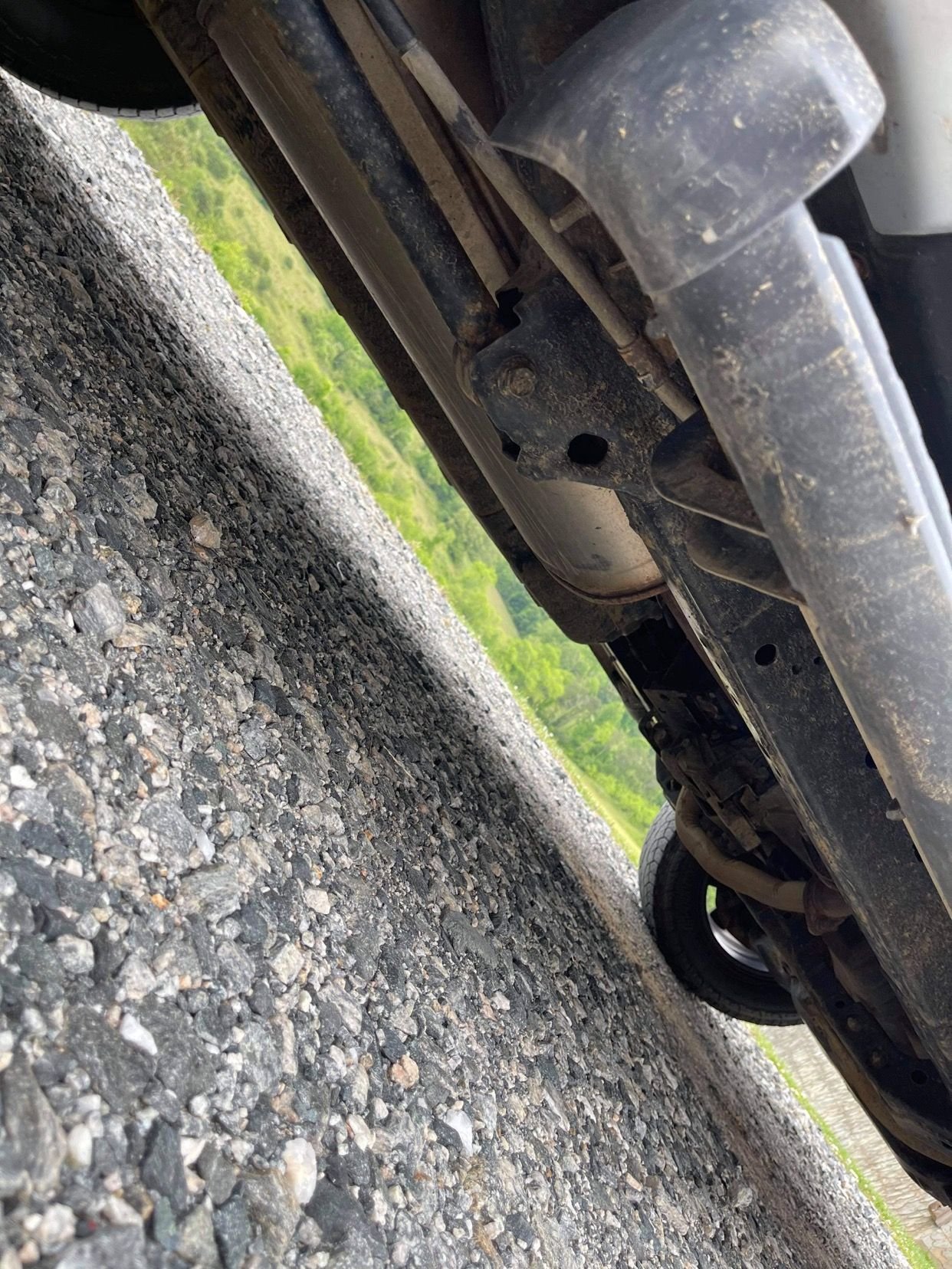

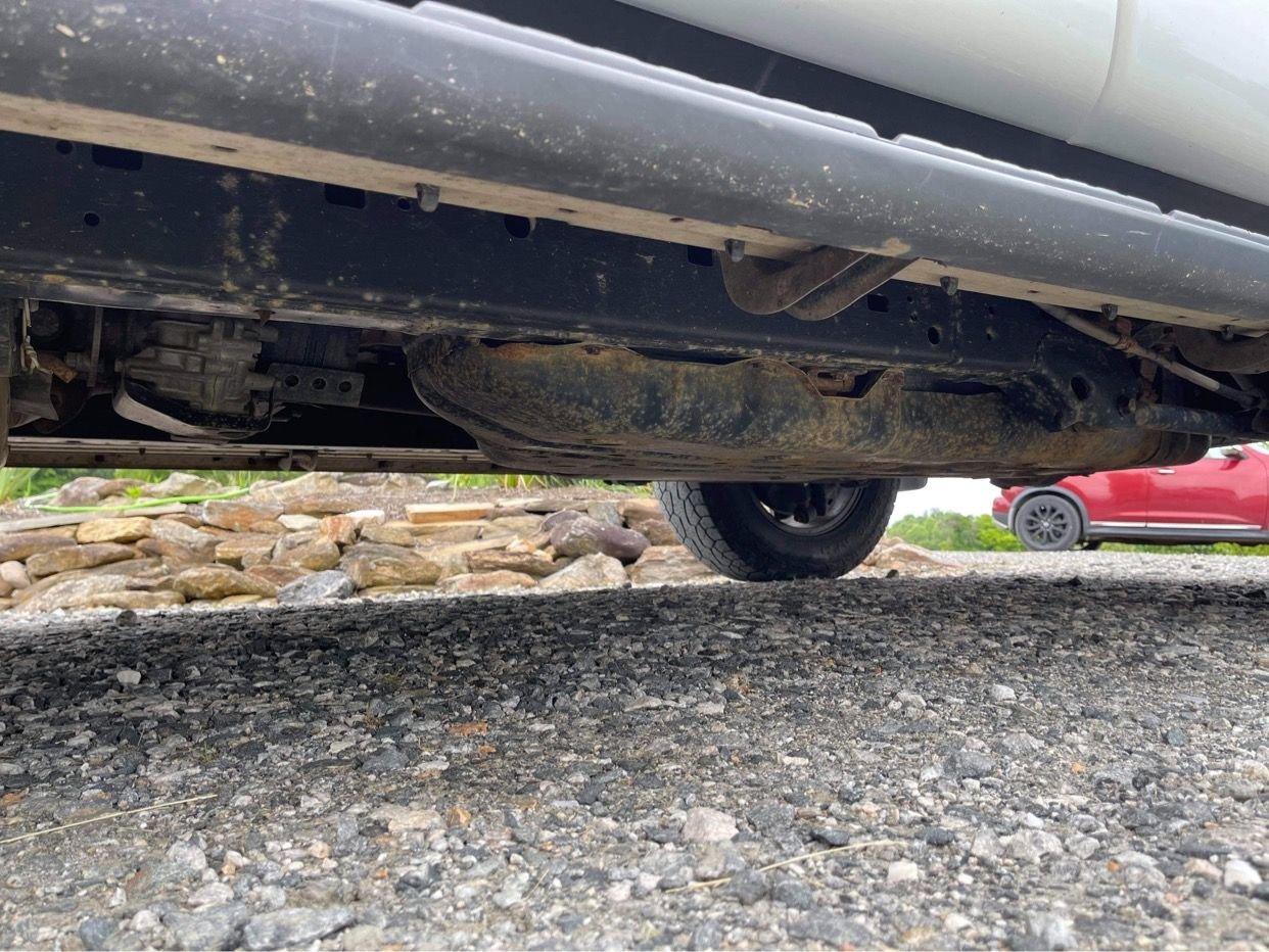

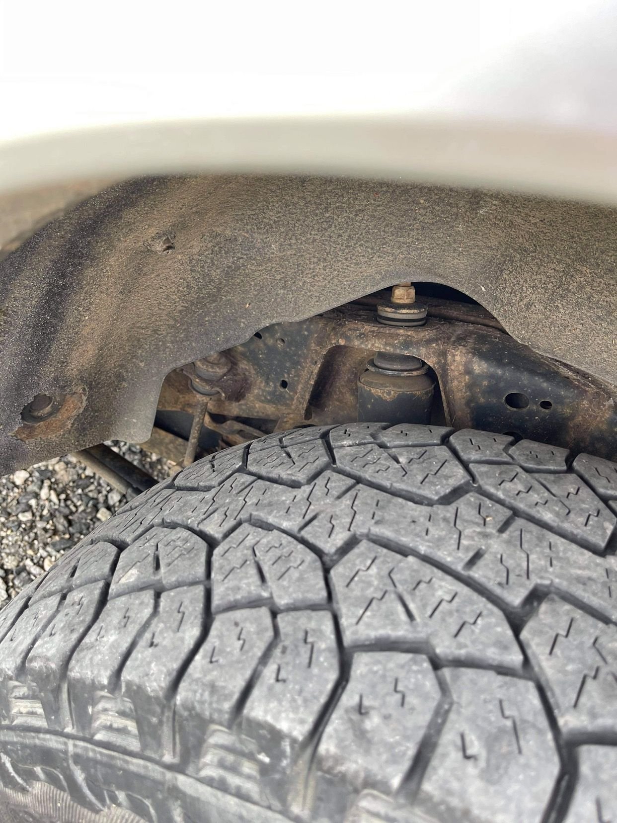

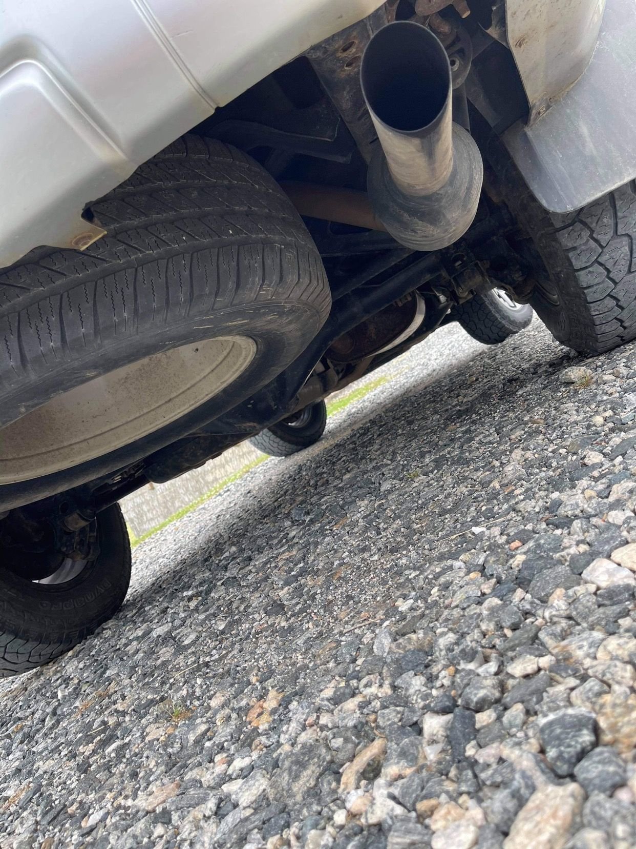

I am looking at a 2007 4R SR5 (4x4) with 159k miles. The seller states he most of the maintenance records and there are no known issues except for the tire pressure sensor. There is some rust underneath (see pics), but I’m not a good judge of rust unless it’s really bad. Can someone advise on the rust? They have added Apple car play and remote start as well as wiring for an amp.Other than that it seems to be in good shape and he is asking $13,500 for it. Would it be a good buy?

I may be wrong without sticking my finger in it, but it looks to me like SOME of the "rust" may be dust/dirt that's gotten stuck. Maybe slide under there and see if you can determine what's rust, and what's not.
Having said that, if it's actually rust, 99% of it doesn't look all that bad, really. Once it's yours, you can hit the underside with Fluid Film, or similar. Maybe clean the surface rust with some sandpaper, or steel wool frist. Very first task, though, would be to hit the underside with a pressure washer to make sure what's dirt, what's not.
Other than that, if the rest is in good shape, and the current owner kept up with the maintenance, it sounds like an OK deal to me. I would dicker with him on the price to try and knock $$$ off for the "rust". Any and every tiny little minor detail you can find can equate to $ off the price, if you do it right. Heck, I would try to talk him down in price if it were totally pristine, but that's because I'm a cheap...errrr...FRUGAL, yeah, VERY frugal...SOB.

Thanks, he did indicate some of it may be dirt. I appreciate your insight on this, and THANK YOU for your service.
I know used cars are up, but I am gonna do my best to get it down. I've seen similar models going near $20K, unreal!
