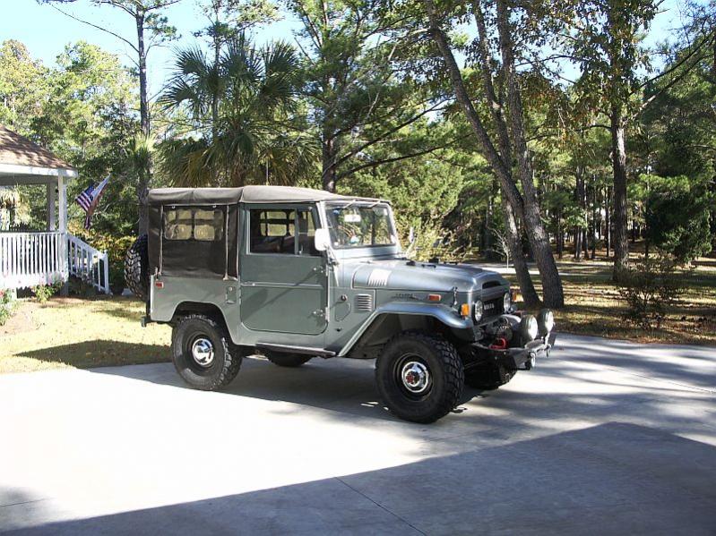

I bought a 1980 Toyota 4x4 pickup when I got out of college, my first non POS car. In the intervening years I've owned a few different trucks, currently a 1973 LC with a 3FE.
