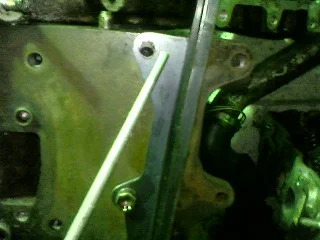

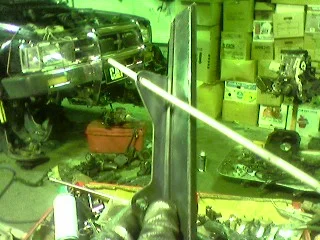

If you have a band saw or plasma cutter, you can make your own VARY simply by using 20R guides and a chain saw file.
Just cut enough off the guide so the cover will fit on, then, using the chainsaw file elongate the hole on the guide that's on the top D-side of the block... You'll see...
Then bolt it on.
That's the same thing LC and DOA do.
