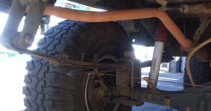

this pictures kinda show what it looks like... im pretty much trying to get alittle more clearance between my tires so they dont smack the top of my wheel well... and my leaf springs seem to be wearing out...

those pics make this thread completely different! your truck has been solid axle swapped, so that makes it a little different. do you have lockers already? your springs in the front look worn out because, to me, they look like a RUF pack (rear springs up front) with stock springs, a block and longer shackles out back. got any pics of the whole truck? shocks aint going to make your truck set higher. you need to get bigger springs, or throw a few leaves in the front pack, or trim the fenders. i would go bilisteins(sp) on the shocks. check out trail-gear.com, marlincrawler.com allpro-offoad.com etc for some aftermarket yota stuff.

Ditch the blocks. get a new spring pack for the rear and get OME, Bilstein or whatever brand you fancy in the appropriate length shock.

what is the deal with the rear axle not looking centered on the rear springs? tires look to far forward towards the front of the fender...

and ask for the tires looking closer to the front part of the fender i have no idea but i just saw that....

Those might be different rear springs...or maybe backwards?..and the bumpstop feature in the shock just keeps the shock from bottoming out hard...has a 2" or so rubber ring on the piston so when the shock gets close to bottoming out it has a small cushion...check em out and you'll see
