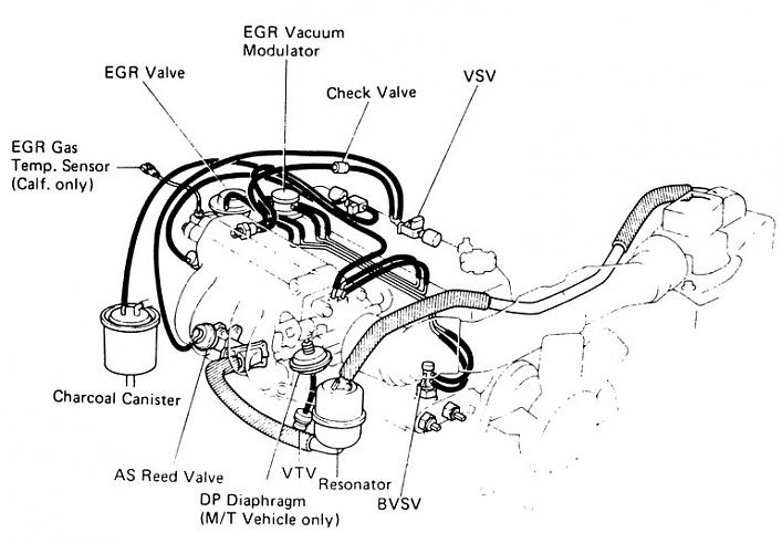

This is the layout of the vacuum lines that i have been working off of from my chiltons...

Here is the VSV that i was referring too.... Am i missing a vacuum line here or am i just missing a cap?
Any help on this would be much appreciated.

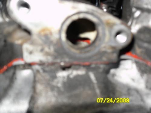

This is the best pic i could get of the opening on the underside of the intake where it meets up to the cylinder head. sorry about how tight/blurry it is, it was the best i could do while snaking a camera back there because the intake is already bolted up and I really don't want to pull it all off if i don't have to.

Old Jul 24, 2009 | 08:55 PM
Plumbrbob's Avatar
Joined: Jan 2009
Posts: 982
From: Tacoma, Washington
Originally Posted by sparx483
on the bottom side of my intake manifold where it connects to the head, about at aprox mid-way back, there is an opening for something with 2 bolts to attach to it, I have no idea what goes there...
HELP!!! thanks!
is it the coolant lines for the heater core?
does it mount up to the head?

Can you get a better pic and wider angle and I will go out to the garage and see if I have mine hooked up and maybe we can get yours done that way.
is it all the way at the back of the head? If so you should have a pipe that runs to the drivers side like this
For some reason my paint will not except jpg files but if you look to the right where the pipe hooks up there are two of them are either one of these the ones your referring too?
Old Jul 24, 2009 | 09:09 PM
olharleyman's Avatar
Joined: Dec 2006
Posts: 3,607
From: maryland
Just ran out to the garage is it any of these 3?
Old Jul 24, 2009 | 09:18 PM
sparx483's Avatar
Joined: Jul 2009
Posts: 15
looks like its the second one... That has to be the pipe that connects to a hose that runs through my firewall then. i will have to go take a look when it gets light out.

the only thing left is that VSV... i see in your pic that yours is still wrapped up in blue tape, but i can tell it has the knob or cap, i'm not sure which it is. Hopefully just a cap.

the shot showing your entire motor from behind.

Its the brownish colored thing sitting on your valve cover that has some blue wrapping on it.
Hopefully the pic will show up now.

If it's the brown one on top of the valve cover I will be loading up a pic in a sec and ashow you where two lines run to.

Here's the pics is this the correct one?
