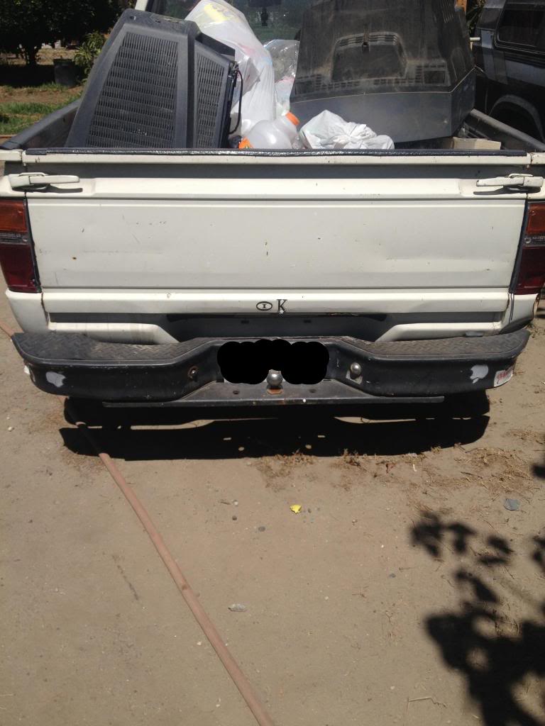

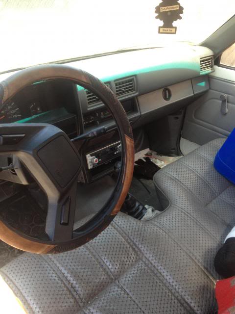

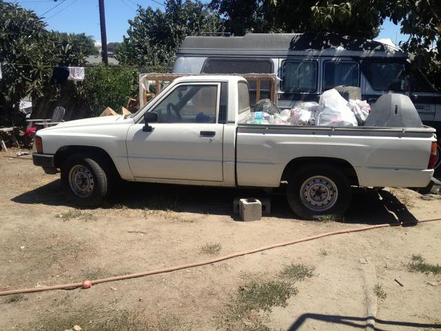

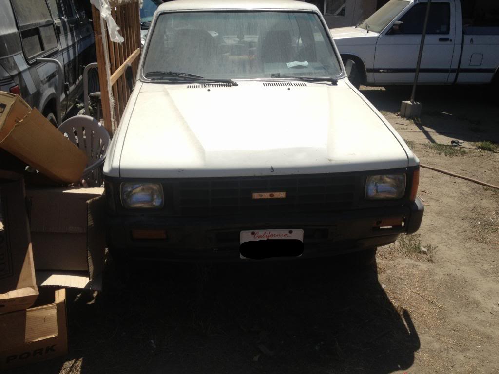

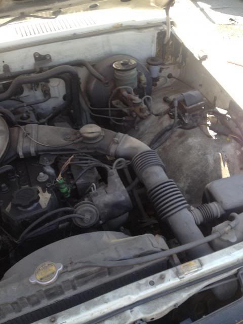

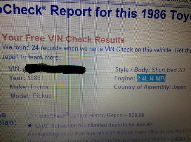

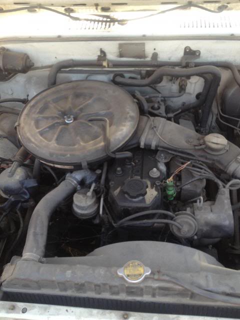

Hey everyone id really appreciate some help here if you guys could direct me to any thread with info on this truck. Also any posts with pictures of this generation hilux for inspiration to build mine. I was given this truck today by my mother after she bought it for 800 at a police auction. It has since been parked for 4 months at one of her friends house so once I saw it I asked her to let me have it. I really dont know much about these trucks so all info will really help thanks everyone.

The people whose house we rented a parking space from threw all there trash on it hence why im taking it now.

Welcome to YT! That truck looks like a great starting place for a 2wd build.

Thanks Duke i'm already going through some threads. I wonder where i can find the bed that the black one has. My bed looks like the bed from an '83 and all the pictures i find of '86s have newer beds.

Black one is considered a US bed, white one is considered Jap bed.
Your truck looks to have a nice, rust-free platform to start with. It should be an awesome, money-grubbing mistress before to long. These trucks/hobbies are addicting.....

You have the correct bed on yours, it is Japanese style, looks like a perfect dash pad and overall the truck looks to be in great shape. I had a 2 wheel drive and Ford Ranger wheels will interchange on it if you find some of them that you like. Your motor is what is called the 22r ( just the "r" will mean carburator). Alot of the info on here that you will want to look for, or hear refered to is 2nd gen trucks. Refers to 4 wheel drives 79-83 being the first gen and yours 84-88 the 2nd gen.
If yours has the 4 speed tranny in it, a truck or Celica 5 speed tranny will fit right in with no modifications needed up until 91/92 I think and that is where they went to an elelctric speedometer.
